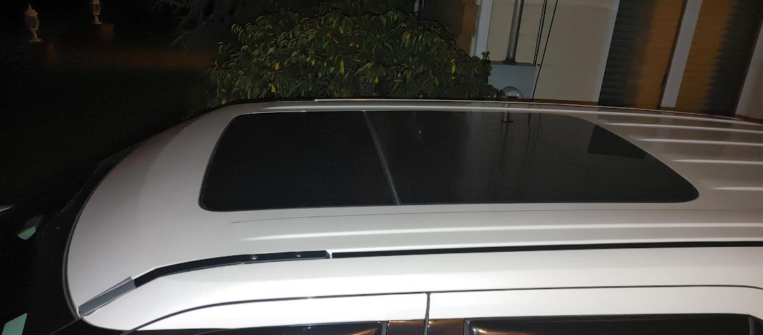

Posted this on two other forums..

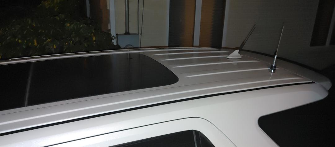

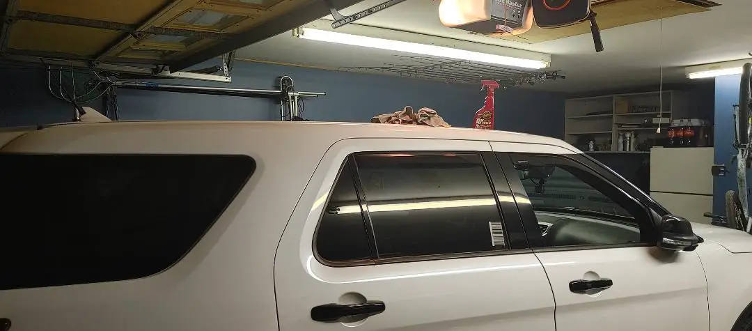

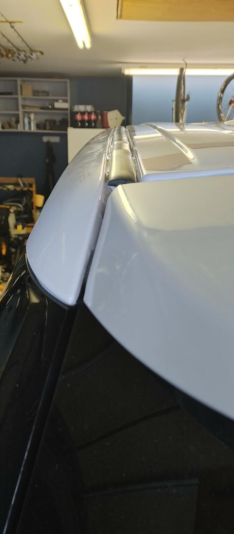

Anyone notice anything different about EcoHell in this photo?
Ok.. what about these photos:
Working on a YouTube video showing the steps, and yes, there are other videos but those videos are showing the stock front clip where you cut it as opposed to purchasing the law enforcement front clips version.

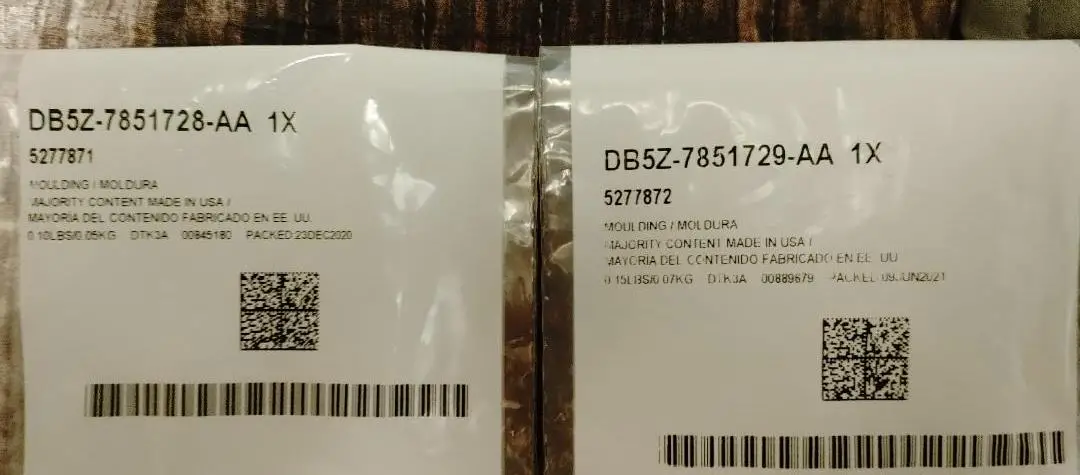

Question for your EcoHell, do you have the part numbers for the trim pieces near the windshield? I temporarily have mine mated down with with 3M VHB adhesive after I painted them gloss black. I'm waiting for the molding to come in tuesday before I complete the rest of it.
I also somehow snapped a stainless M6 bolt trying to get it in on the trim piece and trying to remove it was the cause of the break. Since the PIU trim pieces mount on the two railing mounts, I figured this would be my best path forward.

They are listed and shown in the DIY video I posted in YouTube.. so not to bore you with the video..LOL, here you go..
Kind of expensive trim piece per side for what it is. May I ask what you ended up paying for the two?
I may just reuse the stock pieces and trim the small clip off of it. I also may go look for a wreck PIU at a pick and pull to see what sort of pricing I could get.
I did not think the price was bad..
The only reason why I chose my route is if I sell EcoHell the roof rails goes with the vehicle and the new owner can elect to re-install them with no problems. If I trade her in, I can then sell the roof rails as a complete kit (minus the 4 bolts).
Try looking for a wrecked PIU, if you don't want to spend the money, first.
DB5Z-7851729-AAMolding - Roof Side Trim $47.79
DB5Z-7851728-AAMolding - Roof Side Trim $48.14
What price are you getting?
I was seeing about $100 shipped for the two. The small clip i'm speaking of is just the one that holds the trim piece in place under the rack railing mount. I have some VHB 3M tape that is more than capable of keeping the trim in place if I decide to reinstall the racks.
I'm waiting for my RTV-3 to fully cure before I clean the area to put that molding down.
BTW nice pictures your uploaded to Amazon for the review of the molding you listed. I knew immediately that it was your X.
It was $109 shipped for both.
Did you break the small clip? I reused the same clips that holds down the stock trim pieces. Only reason to touch them is to clean them and then place adhesive on them. When searching for the clips, two will be listed. I believe the black colored clips are for an older version Explorer and to be honest I would have preferred the black ones as they are longer, but if you purchase for the 5th generation, it is the same as the clip you have already on your Explorer.
Thanks for the props on my Amazon review.. LOL. Did you purchase the same molding?

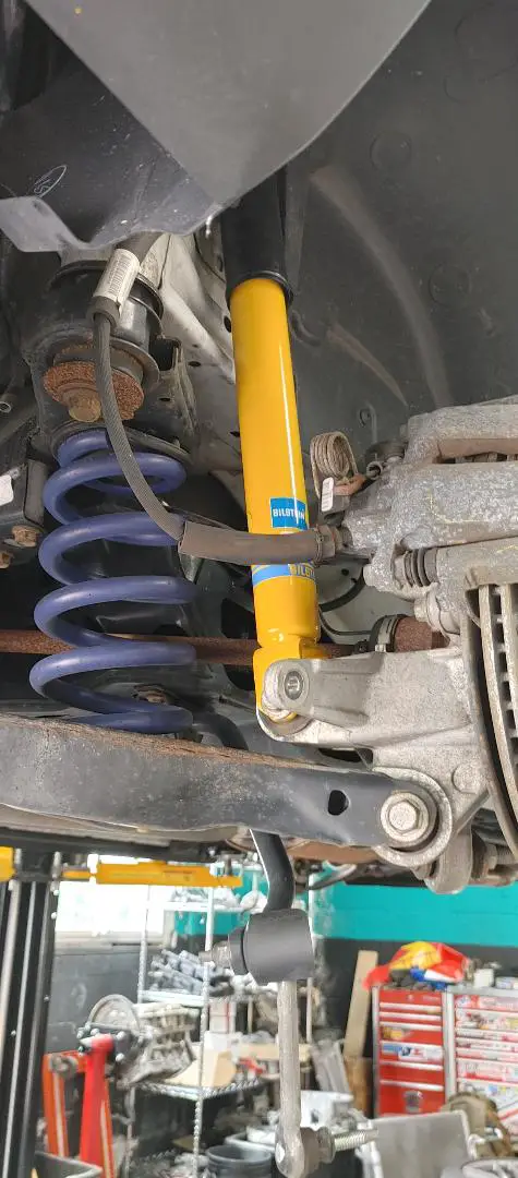

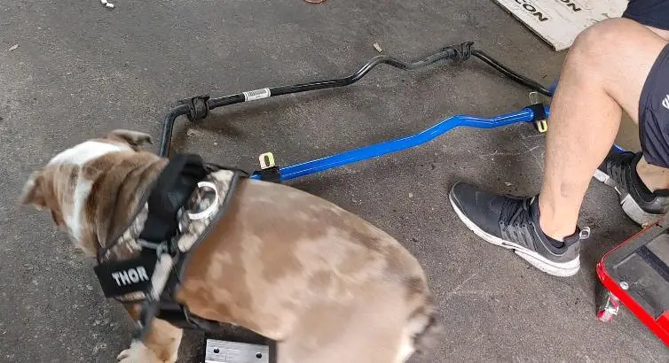

Ok.. it has been a while since I posted here. But more mods have been installed on EcoHell. I had my hands full with my 9+ month old puppy (Thor), at the shop, so pictures were a little scarce..I will take more and update. Any hoot.. enjoy..
Even Thor was impressed with the Steeda Anti-Sway bar...HA!

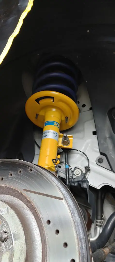

Installed Bilstein B6s all around..

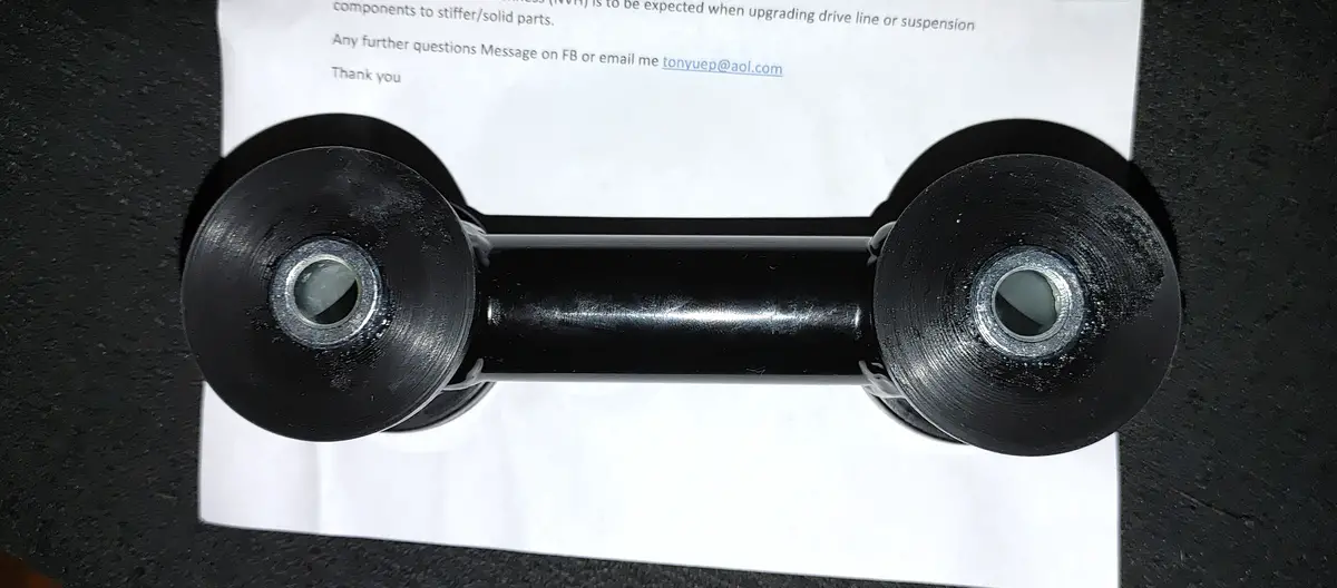

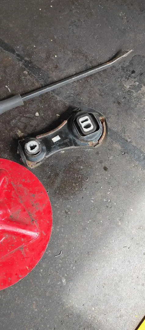

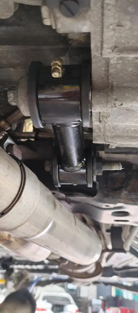

Replaced the Transmission Torque Strut with Tony DiCunzolo's version...
Stock:
Tony's:
