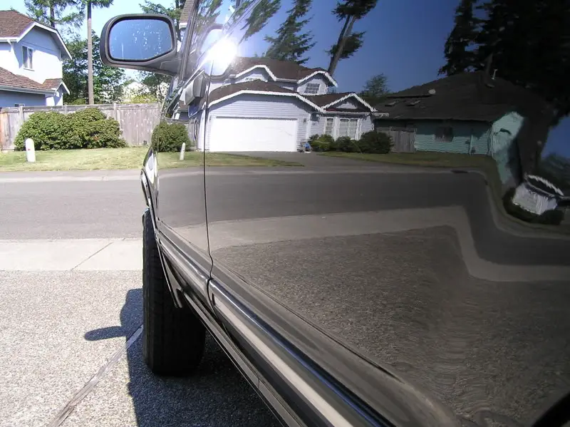

So I finally got the time to clay bar and wax the Expo and all I have to say is Holy S*$#!!!!
I'll let the picture do the talking...
The paint looks awesome now (minus all the deep scratches that won't come out), especially since it is original, so that makes it about 16.5 years old now. I just wish I had done this years ago...
