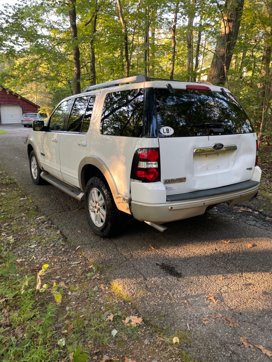

hello, i am new to this page. i have a 2006 ford explorer eddie bauer 4.0 v6 with 230k. this car was great and reliable until the battery died in it. i put a jumper box on the battery and tried starting it to no avail. i put a new battery in it and still no start. the car powers up and all but no crank. the starter is good and tested. i noticed while attempting to crank it the security light was flashing rapidly. i got tired of trying to diagnose the problem and figured id delete the damn system. i found a place in ohio that i could send the pcm to and have to deleted. i did everything exactly as instructed. i pulled the pcm out of the car and put it in a box and off to ohio it went. i received the pcm back after a few weeks, connected it all back up, mind you this is allegedly deleted system now, and tried once again to start it with a good battery. the security light started flashing once i put the key in the run position and we were back at square one again. no crank, no start. any thoughts on what to do next?
