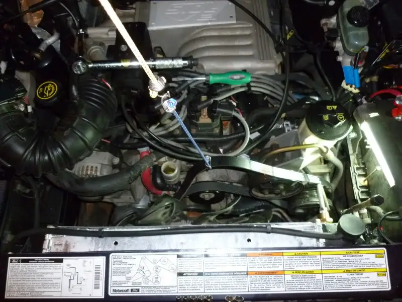

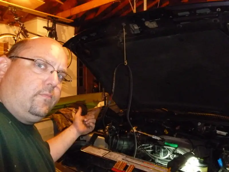

Here is a tip from my radiator install thread:
Tip for belt fitting- since it's impossible to get the damn thing to stay in place on the crank pulley and idler down there, grab a bungee, and hook the top of the belt to the hood. It will create some tension, and you can put the lower portion on without it falling off as soon as you climb out from underneath.
Like this:
