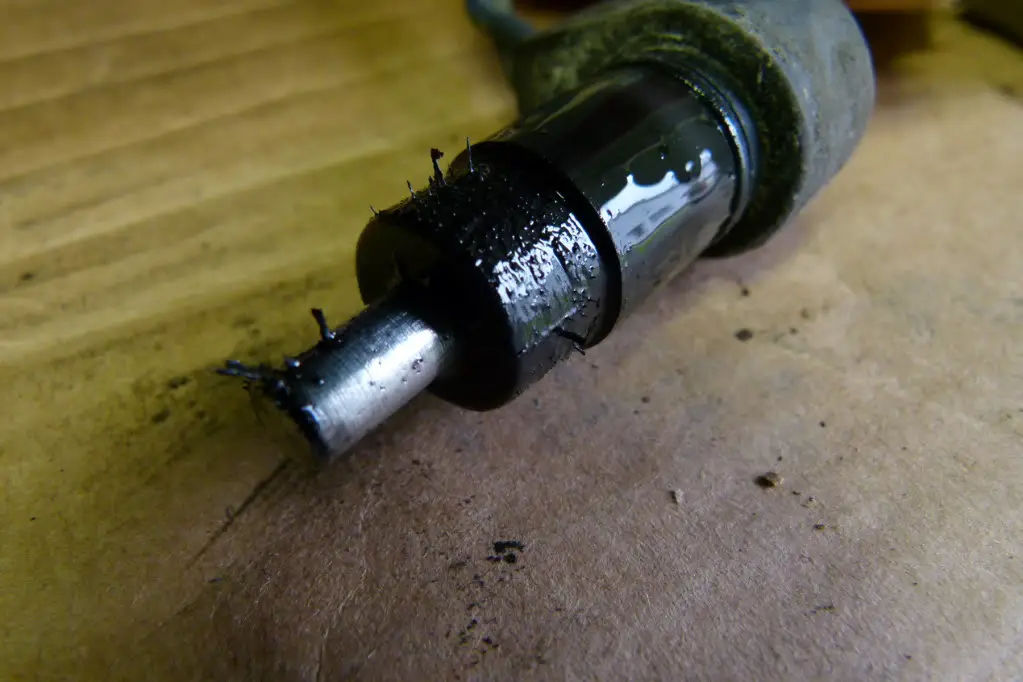

So I was putting new brushes in my starter today after crapin out on me the other day. After I finished I decided to remove my shift motor while I was under there and clean/rebuild it since I've never done it as long as I've owned it, and I've read this is a problem area. When I removed the motor and the magnetic sensor (if thats what it is, not sure what to call it) this is what it looked like. Do you think I should worry about this (metal shavings on it)? Do you think a rebuild is in order or dont worry about it? Any input would be appriciated. Thanks
I'd be draining my transfer case and seeing how bad the shavings are in the fluid, as that's where they would have come from.
