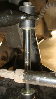

Tricky part here is that ES recommends the front sway bar eyelets parallel to the LCA. Looking at Explorer front
sway bars, the eyelets are angled down. I was blowing out blue Moog bushings quickly with my 2.75" front drop
and cut down the center sleeves the same distance. Same issue. My final solution was using the larger ES 7/16"
I.D. bushings (9.8103) using the Moog K7275 hardware at stock length. Four years without a failure. Link below.
https://www.explorerforum.com/forums/showpost.php?p=2791778&postcount=10
Make sure stabilizer bar end eyelet (B) is parallel with the control arm (C). Many times they are not. You may be required to use a slightly longer or shorter sleeve length than the original. Measure sleeve length (A) and compare to the chart to find the correct set.
http://www.energysuspension.com/universal-products/sway-bar-end-links-set-sizing-charts.html

The info in that older thread might not be the best to go by, based on swshawaii's comments above. I'd say you might want to detatch the end links and measure the distance between the sway bar eyelet and the lower control arm hole the endlink goes through (when the sway bar end is parallel to the LCA) and see what measurement that gives you. The larger 7/16 ES bushings with stock length Moog endlinks as mentioned above might be the way to go rather than just buying 4.5 or 5 inch endlinks.
