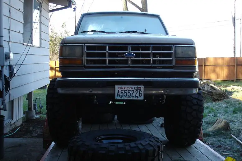

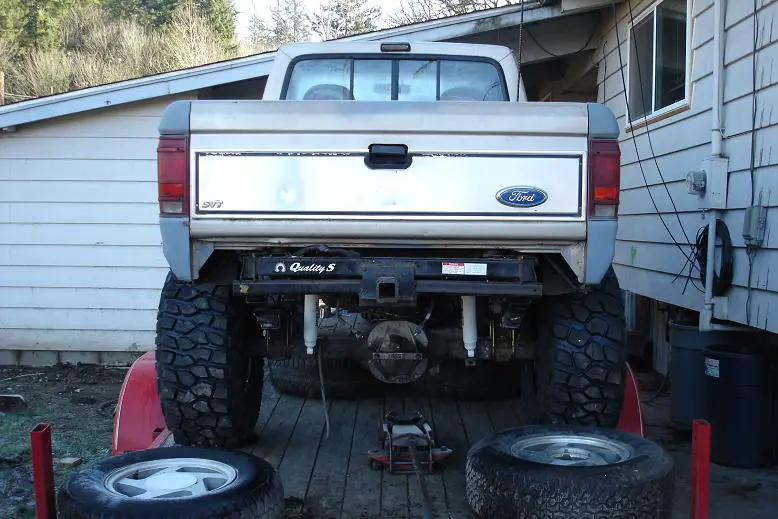

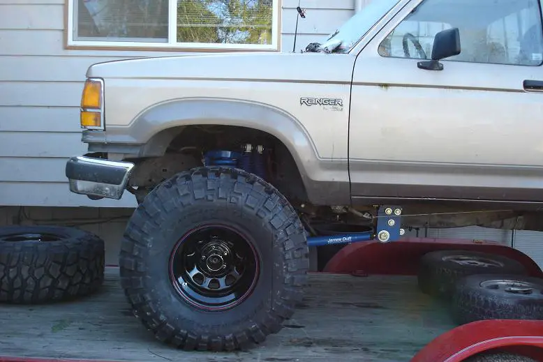

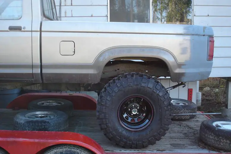

Got my rims in yesterday. I ordered 5 Allied Daytona 61s through Les Schawb. When I showed up to drop of the tires for mounting they only had 4 rims for me. So they had to to another store about 30 miles away to get another one. As they were mounting the tires we found one rim with a really nasty/ugly weld so they had to run back over to the other store for another one.
Looks like I'll be doing alot of fender trimming for these too.

I was originally looking at either Goodyear or BFG MTRs in 33x12.5-15s but after seeing how much the lift actually gave me and test fitting Diff Whack's 35 MTRs; I decided with 35s. After shopping around for tires I found out that my Navy Exchange could get me the 35x13.50-15 Krawlers for not too much more than the MTRs.

I think you'll be suprised at how little we need to trim off the fenders. I would wait on that until you ramp it just to see exactly where it's going to hit. Those tires do look good though, and I bet there is a lot more room in the garage now between the fridge and the tool box:D
