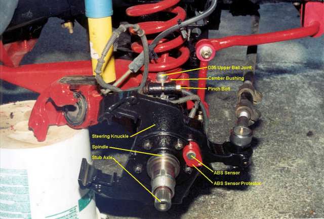

They are located at the top of both steering knuckles and you can see the upper ball joint passes through one in the pic below. When you get an alignment the shop can adjust camber by loosening the pinch bolt and rotating the camber bushing to bring it back into speck.. Camber bushings come in several sizes (degrees) and yours cannot bring alignment back into spec you will need new ones. Most kits don't include them because each vehicle is slightly different and you may or may not need new ones. Usually after you lift you vehicle you bring it into the shop for an alignment and they will let you know which bushings you need.. Of course they'll be glad to install new ones for $$...
