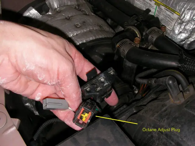

Reduced Octane Plug
You could try temporarily pulling the "octane adjust shorting bar".
Removing it retards the timing for using really low octane fuel.
Shouldn't have any knock then.
It's a two prong plug that attaches to a connector near the
heater core inlet hoses - under the hood near the passenger side.
If that "fixes" the problem, a more permanent solution is the seafoam
that a lot of people here seem to use for cleaning out all the carbon.
Here's a photo of the reduced octane connector with the
shorting plug removed in a 1994 explorer:
