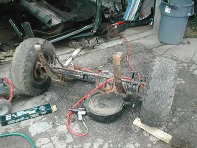

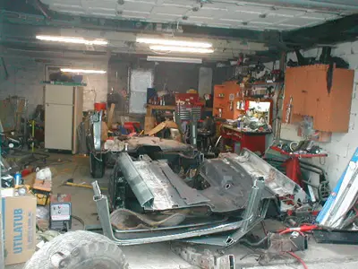

I never thought that cutting a truck apart was so much work, anyway, I got the axle out, it has 2:73 gears in it so Ill be swapping them out... along with a locker.
jeep + Lizard + sawsall =
damn chris it looks like youve been having fun. What are you doing with your old rear axle?
