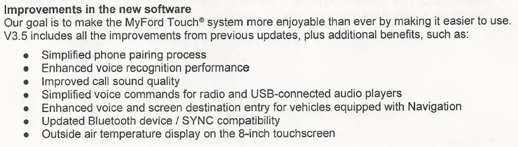

Has anyone else noticed a huge improvement in the BT noise issue since the 3.5.1 update?? It was amazing to be able to hear my wife clearly for the first time since we have owned this vehicle.
Yep, See third bullet. I've noticed a significant improvement in this and particularly voice recognition.
