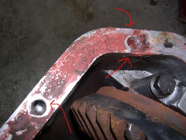

So my 4wd stopped working one day about a year and a half ago... Well when I finnally got it fixed last week(money issues) Heres what we found,
I guess the casing got cracked, let the oil out and water in, got hot, melted and this is what happened, then it completly seized(the little red lines point to cracks):
Notice the lack of a pinion...
:rolleyes:
Time for new gears and a housing. :rolleyes:

wonder how the case got cracked. some really hard wheeling?
-M
I think it happend when I hit a big rock because it bent my radius arm supports and my crossmember too, so I hit it pretty hard. :rolleyes:
That would probably do it.
