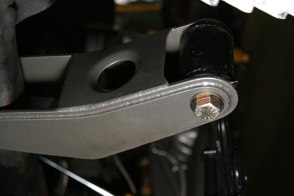

Just want to clarify, the Deaver G50 pack will fit on explorers? And with extended shackles? I can't seem to find consistent answers. And are these about 2 1/2" over stock?

i keep getting mixed stories too! i've seen in person explorers with stock shackles and the g50 pack, but maybe they didn't actually work right?
well i'll let you know in a few weeks if they fit or not
well i'll let you know in a few weeks if they fit or not![]()
You need the longer shackles with the angle because the g50 pack is actually shorter than an explorer pack. The stock shackles will hit the frame and snap off. According to the burg anway...

well see now i heard that the ranger G50 pack is longer than the explorer pack (G50E?) and that all they do is shorten the g50 pack for the explorers. what if you just run the warrior shackle? it doesn't have that bend but it gives more clearance than stock.

Yeah it looks simple enough, just take some measurements...Im sure if you cycle the rear with the deavers youll see where it will hit and it should be easy enough..
this whole thing makes me ---->![]()
Ill get to the bottom of this...Im gonna call deaver directly and ask for measurements...
