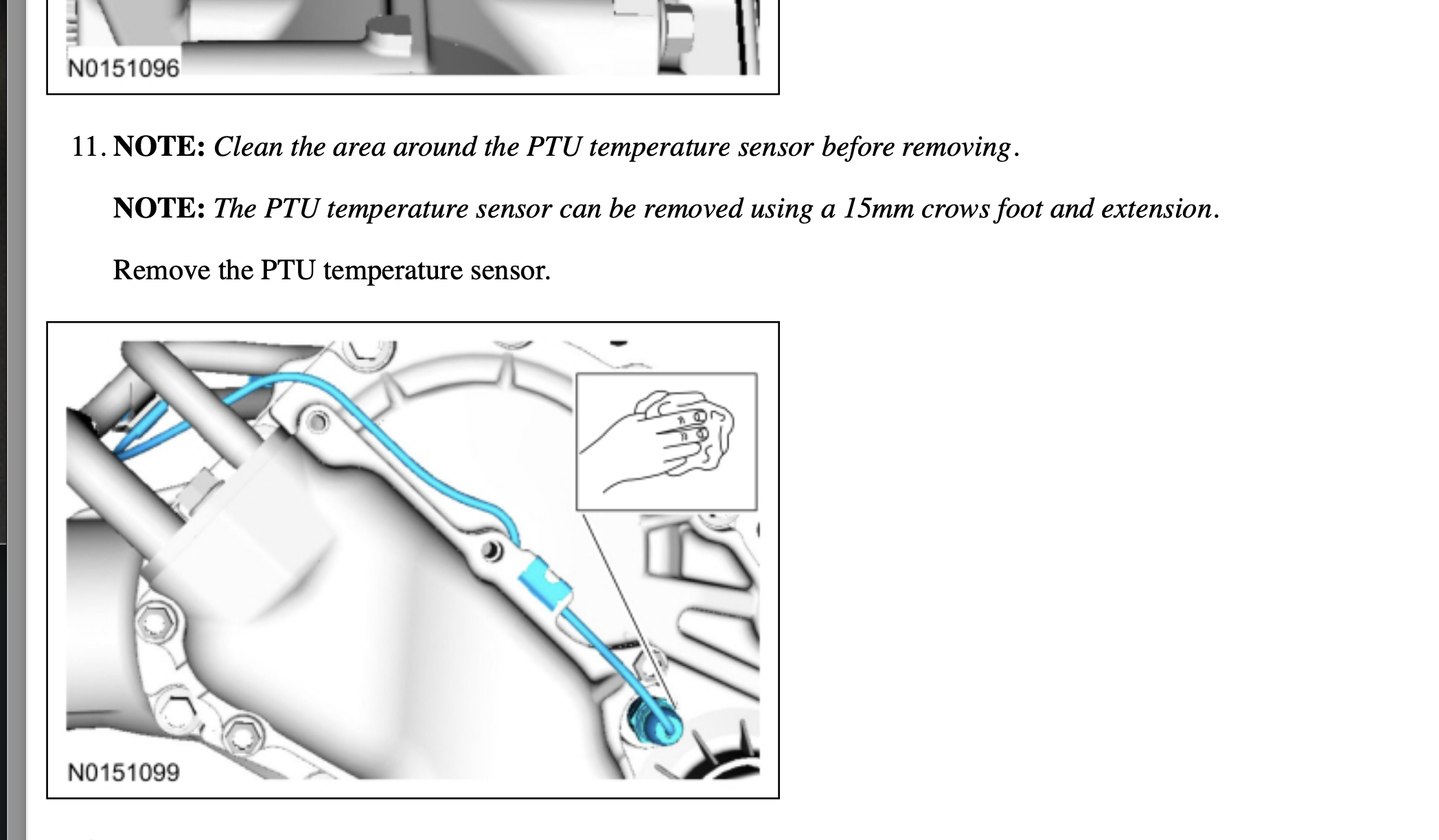

I need to pull the temp sensor from my PTU. I took the rear cat off and got the heat shield out of the way but can't get anything around it to loosen. Is there anyone familiar with the size socket needed? I'm planning on cutting one of my cheap ones up in order to fit around the wiring.

after way too long searching I found the answer, a 15mm Crowfoot.

I was able to remove temp sensor and fill, but when performing finger and wrench contortions to get the temp sensor back in I broke the sensor in the PTU case. 8 ft-lbs is torque spec and I guess my index finger doesn't know it's own strength! Easy enough to get out as the piece left in is hollow.
