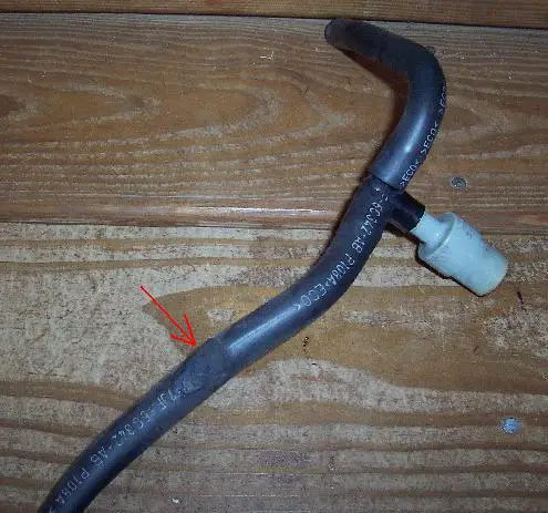

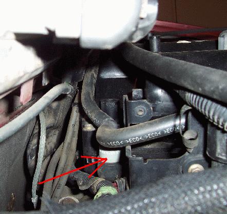

Did your PCV valve look like the photos below?
The hose at the bottom of the valve goes to the breather.
The other two hoses go to the upper intake manifold (one to each side).
