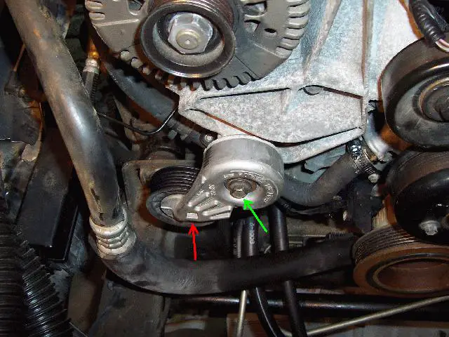

Look at the tensioner, there are marks on it that line up with an indicator. Make sure the indicator is midway between the marks, if that's ok you have the right size belt.
Next remove the belt and by hand turn each accessory pully. They should spin freely. If any are tight or rough, that item may need to be replaced.
