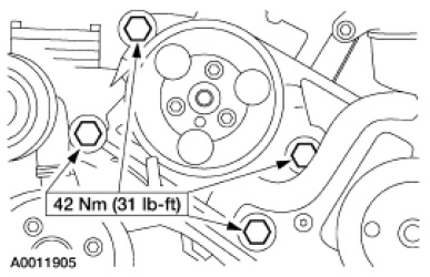

4. Remove the belt tensioner.

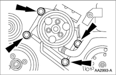

6. Remove the alternator mounting bracket.

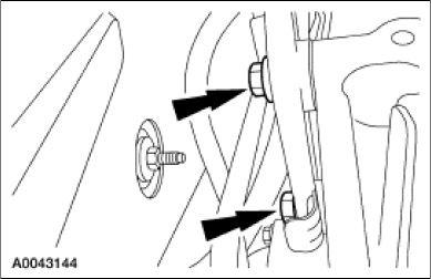

7. Remove the power steering bracket bolts and position the accessory bracket aside.

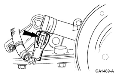

8. Disconnect the crankshaft position (CKP) sensor electrical connector.

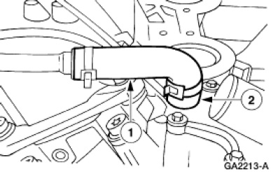

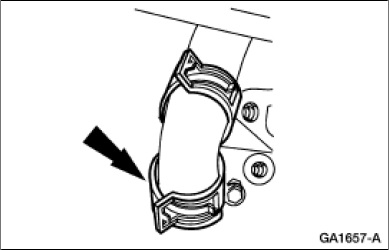

13. Remove the upper heater water hose.
1. Squeeze the heater hose clamp.
2. Remove the heater water hose.

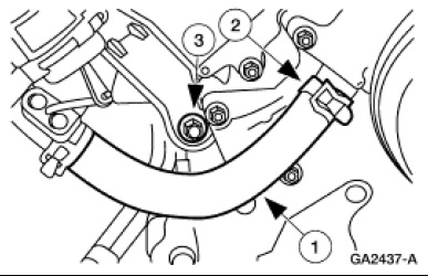

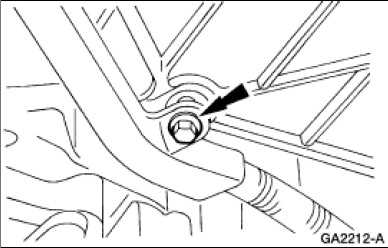

14. Remove the lower heater water hose and position aside.
1. Remove the bolt.
2. Squeeze the hose clamp.
3. Remove the heater water hose and position aside.

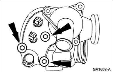

17. Remove the crankcase vent separator spring steel clip and remove the separator.

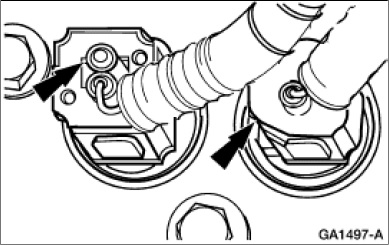

19. Remove the exhaust manifolds.

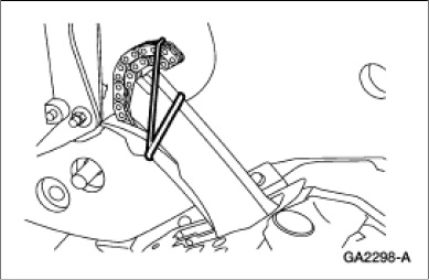

25. CAUTION: To avoid breaking the left cassette, remove the camshaft sprocket from the chain and cassette to gain clearance to remove cylinder the head.
NOTE: Hold the chain and cassette with a rubber band to aid in removal and prevent the chain from falling into the cylinder block.
Remove the LH camshaft sprocket from the cassette.

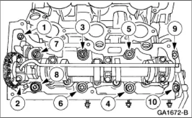

26. Remove the eight 12 mm bolts and two 8 mm bolts in the sequence shown and remove the LH cylinder head.
Discard the head gasket.

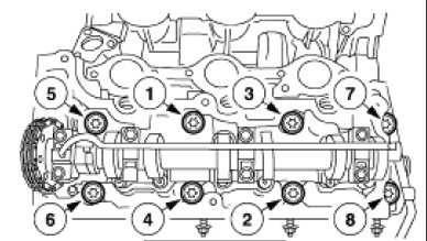

31. Remove the two 8 mm bolts and the eight 12 mm bolts (T55) in the sequence shown, and remove the RH cylinder head.

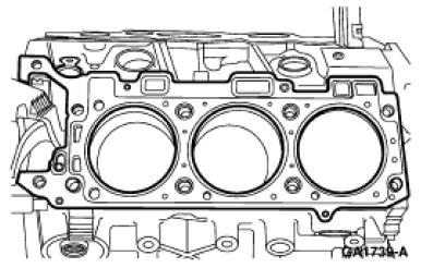

1. NOTE: The LH is shown, the RH is similar.
Position the cylinder head gasket and the cylinder head.

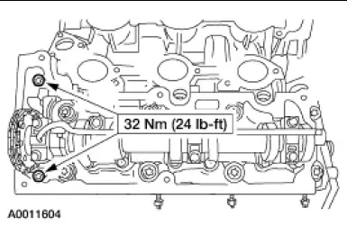

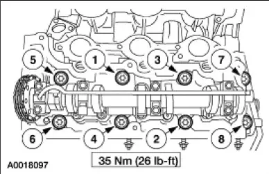

Install the 12 mm bolts (T55) and tighten in the sequence shown.
3. NOTE: LH shown, RH similar.
Install the two 8 mm bolts.
4. NOTE: LH shown, RH similar.
Tighten the eight 12 mm bolts (T55) in the sequence shown in two stages.
 Stage 1: Tighten the bolts 90 degrees.
 Stage 2: Tighten the bolts an additional 90 degrees.

16. Install the thermostat housing.

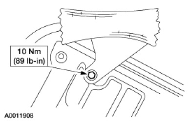

18. Install the lower heater water hose.
1. Position the heater water hose.
2. Squeeze the heater hose clamp and position.
3. Install the bolt.

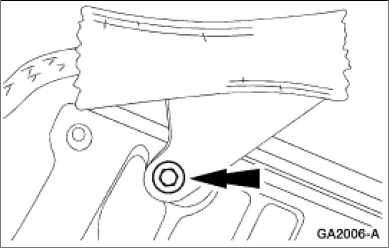

19. Install the upper heater water hose.
2. Squeeze the hose clamp and position.

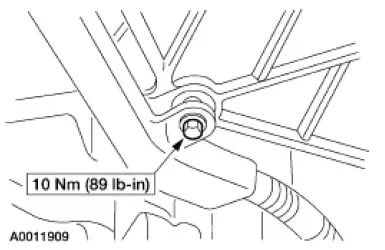

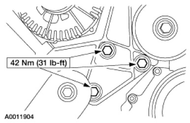

25. Install the accessory bracket.
26. Install the alternator mounting bracket.
SOHC V6 Heads installation (Continued)

28. Install the belt tensioner.
