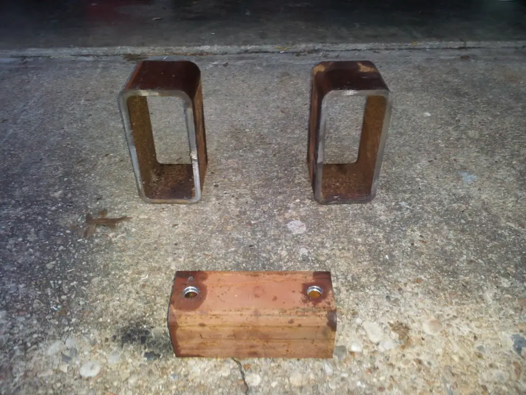

got the metal today and cut them down.just need to weld them up and drill holes.i think i may take an old tire and cut it up to little squares and put them on the mounts to cut down on vibrations or allow a very little bit of movement,may take alittle stress off things.or you think just go solid ?
the material im making the mounts out of,top two is engine and bottom is trans.the engine ones still need to be cut down to an angle and plated[/B]

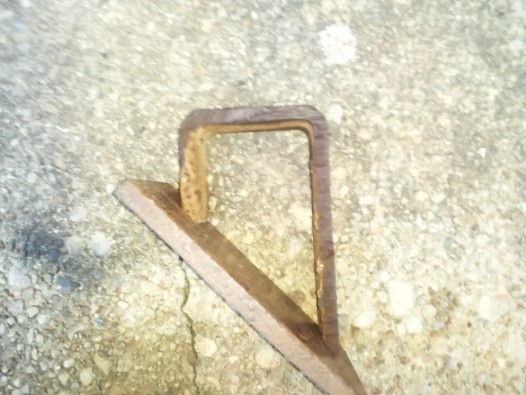

like this but smaller
