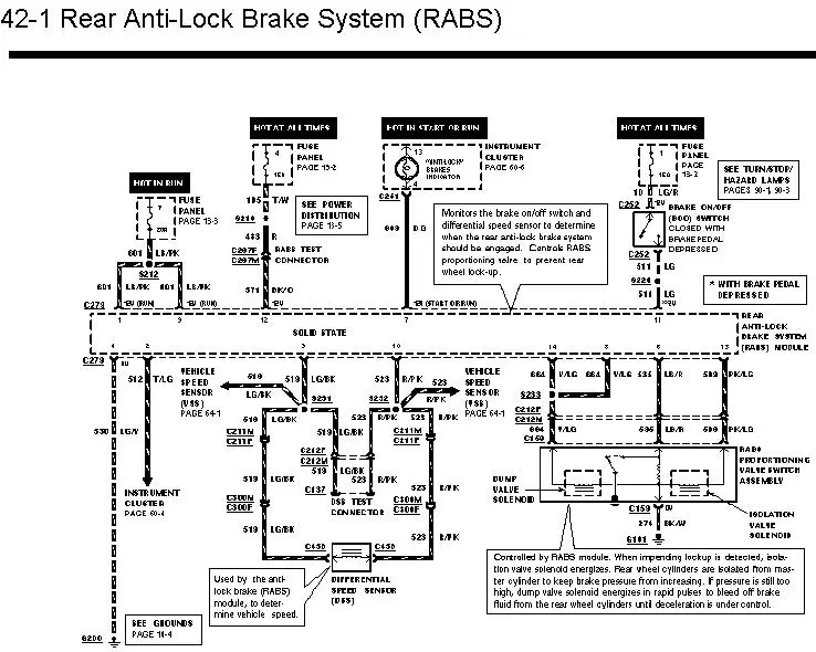

ok, post #4 tells me to "To see if the Delta P switch is the cause of the illuminated warning lamp(s), disconnect the two-wire connector (on the Delta P switch) and jump the two wires together."
but there is no 2-wire connector, the only connector has 4 wires, (at the combination valve). Otherwise I don't know where the Delta P switch is, and it is not at the Master Cylinder, mine is a 1997. The only connector at the master cylinder is a 3-wire connector at the bottom center. (for the fluid level switch).
1997 Aerostar RABS schematic diagram.
This schematic was taken from my Ford software.
where is the Delta P Switch in this diagram? I can't see anything that says "Delta P Switch".
This tread about the RABS is still a bit confusing, special about the naming of certain parts of the RABS system. Even the Haynes ABS techbook is clear in the schematic but lacks proper naming. Ford calls this hydraulic RABS valve.
I got a 1994 Aerostar (given to me) and someone cut out the part after the master brake cylinder and between the combination valve (Combination valve = accumulator+Dump valve+iso valve)
I assume reading this tread; there is a pressure differential valve (with Delta P switch) this must be the one right after the Master Brake Cylinder (Haynes manual calls this combination valve in the schematic) So what is the right name for this valve?
2 lines from the Master go to the top of this valve. Right and Left front brake lines go out.
1 line goes to the combination valve. There is a elec. Switch on top with 2 wires which will operate the red brake light. If this one shorts out; bridge the connector and light will go out. I have a 1996 which has this hole properly capped without a switch maybe Ford idea or some other mechanic.
Just an add on to my message above. Looking at the RABS schematic in this tread the combination valve is called in the schematic; RABS Proportioning Valve Switch this has a 3 wire connector going to it and is fasten to driver side fender cowl.

Well it took me the whole day yesterday to figure it out the Aerostar RABS (I will never stop till I do anyway).
Ford calls the first valve after the Master Brake Cylinder (MBC) the Combination Valve. This valve has differential pressure between the front disc and rear brakes. The front disc brake need more pressure than the rear. Has a 2 wire switch on top to activate the red instrument panel light. This switch has a tendency to shorten out to ground (see Jamey Mcfarland story) This valve has different names on EBAY etc. so good for standardisation.
After the Combination Valve comes the Proportioning Valve (Hydraulic RABS Valve) this is for the Rear ABS only (valve with 2 solenoids on it). This valve (the name says it) proportioning between the brake who wants to lock up. When this valve is not functioning proper the orange ABS light comes on. This valve is named by many Combination Valve; yes also in the aftermarket auto parts. Yes confusing. The Haynes ABS Tech-book and the elec. diagram has helped me to figure out the proper diagnostic for this simple RABS brake system.

Combination Valve sticking (out of center); Red Brake Light will be on. But also when the switch is grounded (for checking ground; bridge wires and light should go out).
Proportioning valve sticking or leaking to accumulator in valve; Orange ABS light will be on.
