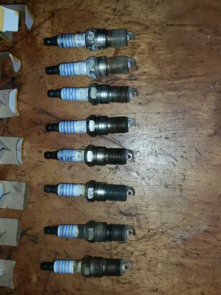

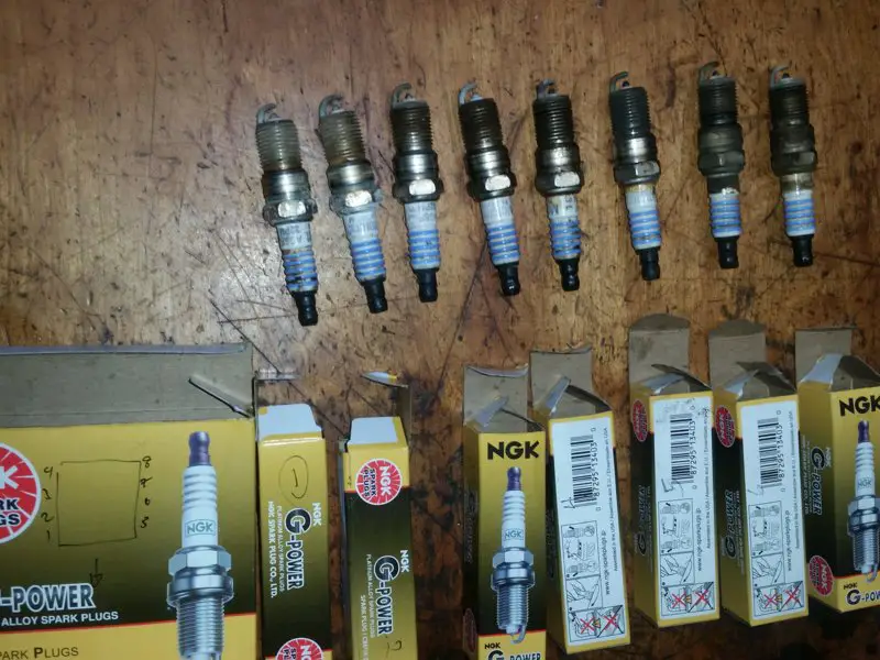

Fist off I went and purchased a set of NGK 3403. I general I am a fan of NGK plugs and run them in most engines I own. Typically I would stick with the manufacture recommended: Motorcraft for Ford, Denso for Toyota. However I deviated this time and put both NGK plugs in my Ford and Toyota.The platinum tip of the NGK plugs are much finer than the ones found on the motorcraft SP-493. The current plugs had only about 50K on them (if the service records are correct). They however had a bit of wear. These are the MC plugs with NGK boxes. Laid out left to right from cylinder 1 to 8 (top to bottom on the second picture). I drew out a diagram on the box, and am pretty sure that is also the correct firing order and cylinder naming convention. The passenger side bank appeared to run leaner than the driver side. Cylinder #4 was the "leanest". The wear on each plug was also inconsistent. Some electrodes had more wear, others had more wear on the strap.
