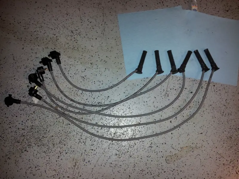

Just a heads up for anyone replacing aftermarket Spark Plug Wires (which can use the same length more than once) with the stock Motorcraft set (WR6096) which uses a different length wire for each cylinder. From shortest to longest the wires go to cylinders 4, 1, 5, 2, 6, 3.
