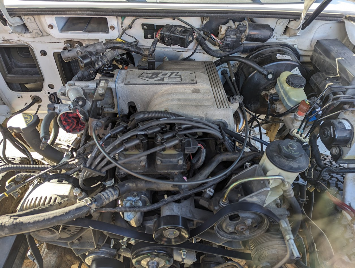

Got my swap up and running mostly. Need to fix the AC and I think I destroyed a u-joint on Sunday. Taking the trailer up to grandma's tomorrow to retrieve it and diagnose.

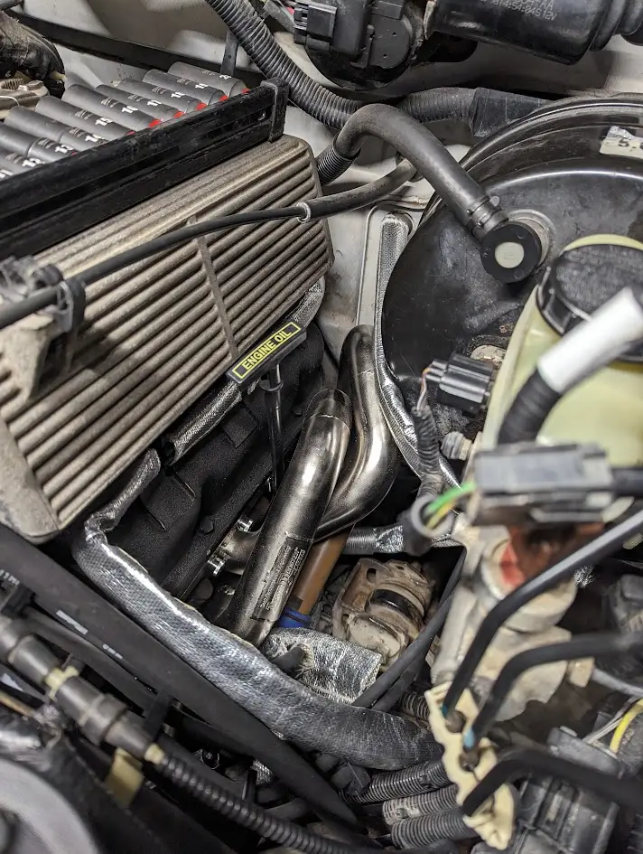

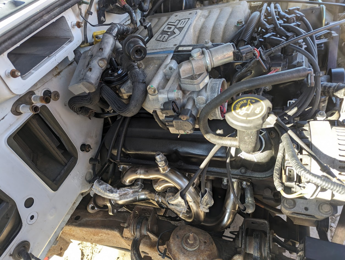

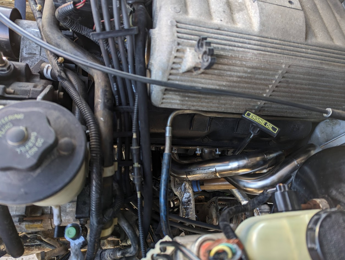

I got the SKP wires installed and they are working well. I need to go through and do some better routing and I'd also like to install some additional heat shielding. I'd like to peruse your posts for routing inspiration.
For heat shielding I'm leaning towards the Kingsborne Boot Insulators where shields weren't provided, maybe in place of those too, and might install some heat reflective sleeving on the last foot or so of the wire near the headers. For next set of wire's I'm planning to go custom built with ceramic plug boots, but this set was just right to get the truck going.

You do not need that
Much heat shielding! Good wires only need 1-1.5” of airspace between header and bare wire
I'm running a mix of OEM shields and 6" sleeves with my TMHs. I mixed and matched the wires with convenient lengths and swapped the shields accordingly (just pry the tabs with a hose pick/screwdriver and pop them apart).
I also moved one of the plug wire clip brackets to the back of the right head and ran the #4 wire around back.
I like stuff to look factory, so I used a bunch of different plug wire clips I snagged from the salvage yard to keep things tidy.
If you already bought some longer insulated sleeve material, I recommend using it on the fuel line and front right brake line where they run along the headers.
