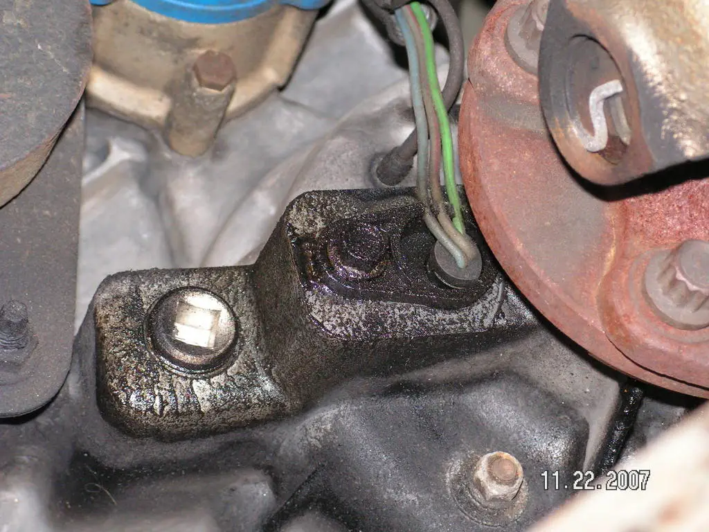

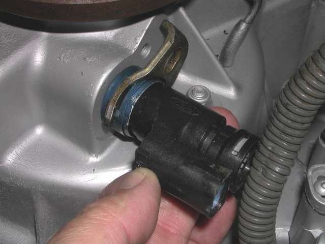

ok so i looked again, and this time i took another picture. This pic has what i thought it was before but now there is another item (the black thing) that i guess it also could be. I have no idea. What threw me off is that what i initially thought it was has 3 wires coming out of it. The black thing has 2 wires coming out of it and looks more like the pics of the vehicle speed sensor in the other pics? Can someone please let me know if im going crazy? Thanks
http://s212.photobucket.com/albums/cc8/belyeodezhdy/?action=view&current=ebay4052.jpg
You are likely just feeling a difference because the truck has to work harder to turn the larger tires. My friend had 33s on his Explorer for a long time and never had a problem other than the speedometer being off.
I was going to replace the gear in my truck after getting 31s, but the other day I decided to test how far off the speedometer was with a hand held GPS unit. Both the speed reading and odometer reading were almost spot on with what the GPS unit said (off by no more than 1/10th of a mile). I'm happy with that. No new speedo gear for me.
thanks for the reply, i just changed my speedometer gear anyway, but it will still be off a little since my calculations equaled out to needing an 18.8 tooth gear . I took it for a quick ride today, but hopefully tomorrow i will get someone to keep pace with me and let me know how much im off by.
