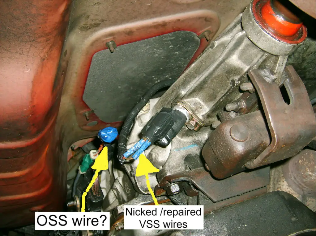

I have a similar problem... 97 EX 2x4 4.0L V6 - tripping 0720 (output shaft speed sensor) O/D flashing, no 5th gear or overdrive, 2-3 flare.
1. Found VSS wires nicked so I cut and crimped - Speedo still works, Still tripping 0720
2. Replaced speedo gear to adjust to correct speed - speed fixed but still tripping 0720
3. Replaced VSS - Speedo still works, Still tripping 0720
4. Adjusted Bands - Speedo still works, Still tripping 0720
After reading as many post as i can find and working with Brooklyn to get these steps all done I believe I have a wire/short issue? In several posts and manuals I read the following:

For 97, the OSS sensor and code P0720 have nothing to do with the speedometer.
The OSS supplies output shaft RPM to the PCM for transmission control calculations only. Look for the OSS on the DS rear of the transmission case close to the top (dark blue/yellow and gray/red wires).
The speedometer, radio, speed control and PCM all get vehicle speed information from an AC signal originating at the VSS signal generator in the DS of the tailhousing (gray/black and pink/orange wires).

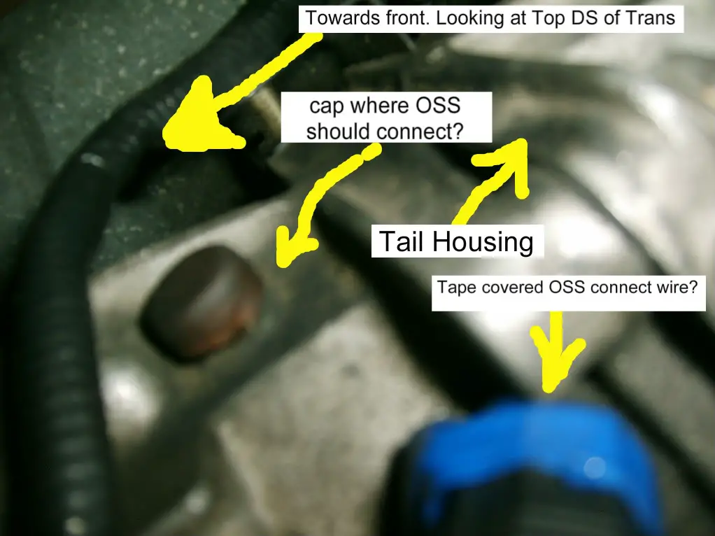

Thanks RWENZING, found the connector with the wires you mentioned, and nowhere to plug it in... now the rest of the story... Have been told by a tranny shop I have a 4R55E instead of the 5R55E that's supposed to be in there. Nobody could tell me how to verify that since the body is basically the same and their is no tag. I read on another post that there was a wire for the Overdrive speed sensor on the 5R55E (vice Output Shaft Speed sensor) that was no longer used (was only used short term and later abandoned) so it was to be cut and soldered together (verified that with the tranny guy at Ford). I assumed that was the same wire so it didn't concern me and I jumped it closed with no effect. If you're saying it should be connected could the solution be to jump the VSS to the OSS connector?

Heres some pics. Looking at another post of the 4R70W OSS I'm assuming I found where it should be. There is a cap over it, it is loose as if it could be popped off. I didn't see or feel where a bolt would go to hold in another sensor.
This is why I thought the wire was not a factor...I take it the ODS is not the OSS as I had thought?

If there is no place to install an OSS as I suspect (unless it will fit in the capped looking location in the pic) and jumping the VSS signal to the OSS won't work, would the RABS signal work connected to the OSS cables?
