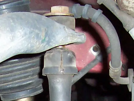

While working on the installation of my engine oil thermostat I noticed that the left front sway bar link had failed.
The spacer bottom grommet has been pushed past the spacer (poor design).
The spacer top grommet is cracked and would soon look like the bottom one.

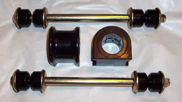

I decided to purchase a sway bar bushing and link kit from Energy Suspension. Their website lists my front bar as having a 34 mm diameter. Using calipers to measure the stock bar I got a similar measurement so I ordered their kit (Part Number: 4.5155)
There are two colors available (red and black). I learned from the product description that the black polyurethane contains a graphite lubricant while the red doesn't so I ordered the black. The link design is superior to stock because the outer diameter of the washers is large enough to prevent the grommets from being pushed past them. The link bolts, spacers and washers are heavy duty and should last many years. The bushings have molded depressions to hold the provided lubricant. I was surprised that the bushings are not split and am a little concerned about ease of installation.

Split bushings
. . . I was surprised that the bushings are not split and am a little concerned about ease of installation.
When I started applying lubricant to the new bushings I realized that they are split. They just fit together so well it wasn't obvious. I removed the old bushings which were actually in fine condition. After installing the new bushings on the bar I decided to press the bushings into the mount using two pieces of plywood and a C clamp.
