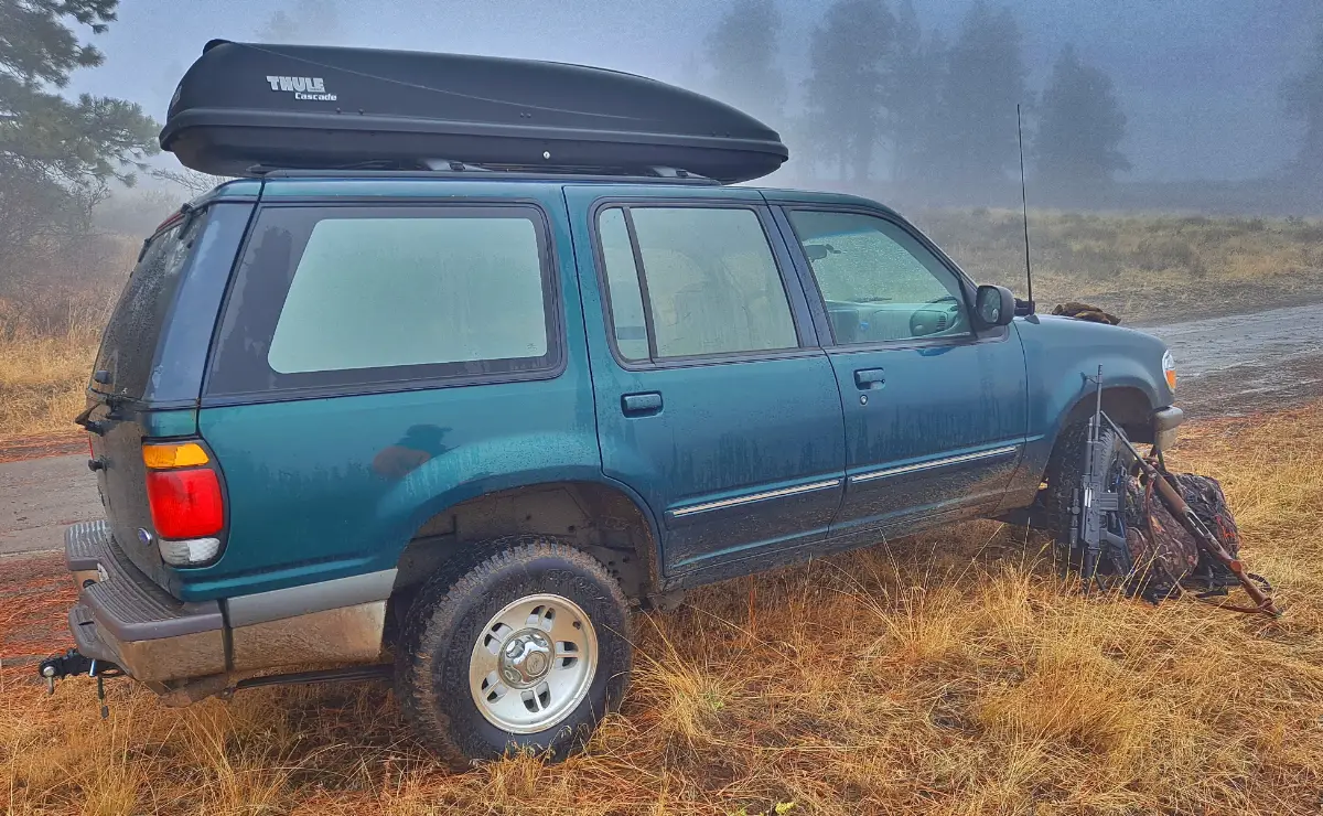

My dad and I both have Explorers (96 & 00) that have been lifted about 2.5" through TT and shackle/AAL.
Last year we took my 96 hunting and ended up on some FS roads that were just awful. Total moonscape of rocks & washboard. I was trying not to beat the **** out of the truck, but by the end of that trip I could hear my sway bar end links knocking pretty bad. I torqued the link bolts a bit but the bushings are already practically crushed as-is.
