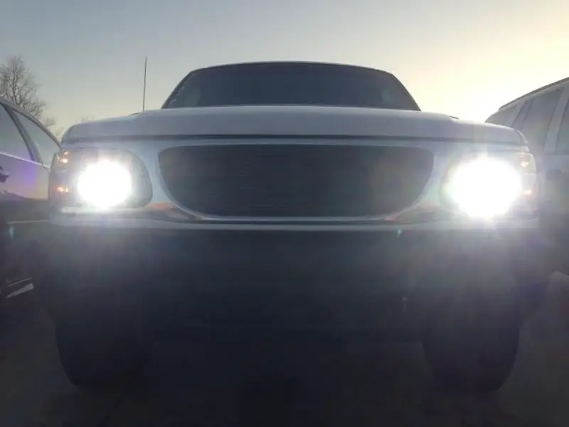

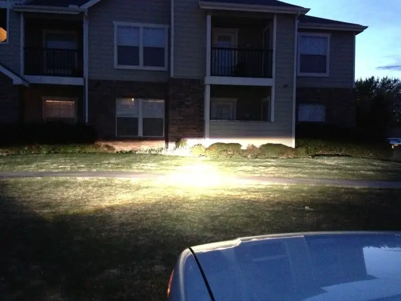

Got the retrofit done, from a distance the lenses looked smoked, but up close they are crystal clear, and the light output is amazing
In the last pic it looks like there's a hot spot, there is really not, complete even light output

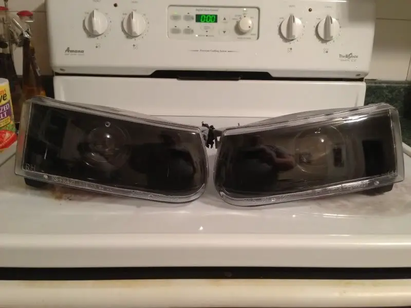

Yep exactly what I would've told you just got a chance to look at the forum, I used a full set of ebay clear housings, the corner light were already black, but the headlights were chrome reflectors with black sides and top, just sprayed some duplicolor adhesion promotor, then black fusion, matches exactly to the corners
