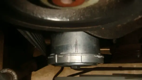

Hey,
Not that this issue hasn't been pounded to death but I need help from those who have fixed this. I have an 03' Explorer 4.0 V6 sohc. It has for a long time been making a squealing noise on start up that is very similar to belt squeal. I figured this is a no brainer so I replaced the belt, idler pulley and tensioner with motorcraft parts from the stealer. Problem still there. So I remove belt and check all accessories for bearing issues. I detect the smallest bit of noise from the forward bearing on the alternator so I replace the alternator. Problem still there. I remove belt again and re-inspect all accessories for any previously undetected issues. Nothing is misaligned or tight or rough in any way. That includes the water pump, power steering pump, a/c compressor, fan clutch and vibration damper. The damper looks normal, ie: not separated. I marked it to check for possible slippage and found none. I've read more on this subject online than i care to admit. I'm a capable mechanic and take care of my own stuff. I pulled the cam sensor and inspected hoping to find a synchronizer below it but there isn't one in this motor. This motor has about 140k on it, runs smooth and gets decent gas mileage. I read that the timing components on this motor can be problematic due to chain guide wear. I need to eliminate all possibilities before opening up the front of the motor. What am i missing?
Thanks,
John
