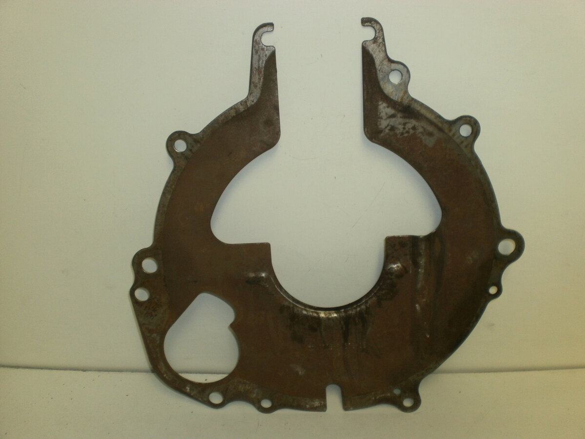

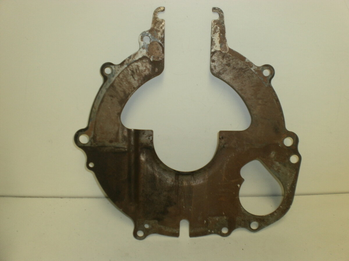

First I think you mean "flex plate" not "flywheel." Flex plates are used for automatics. There should be a thin spacer plate between the transmission bell housing and the engine. Check to see if that is still there before we go any further.
No there is no plate between bellhous and motor,and yes IAM sorry I keep saying flywheel but it is flexplate,,it's 2001 expl xlt 4.0 sohc with automatic awd.some one said that model does have a plate and some days it does and some say only ones with clutch standard.. I have been trying to find the specs for trans mission and for starter to see if I have the wrong starter but 3 times brand new ??maybe,can anyone help me find specs or measurements for starter and measurements for flexplate to starter and also my flexplate was replaced with atp z 349
Block plate
