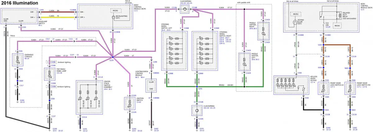

The steering wheel button backlights are on their own circuit from the rest of the most of the controls. Only thing on the same lightning circuit are the switches to the lower left of the column, aux climate control control (if equipped). start/stop switch (if equipped), and the "top finish panel lamp", whatever that is (it's in the center console).
If any of the other LEDs work, then it's likely the clockspring is the issue. If none of them work, then it's an issue in the SJB, perhaps the FET protection circuit has been triggered.

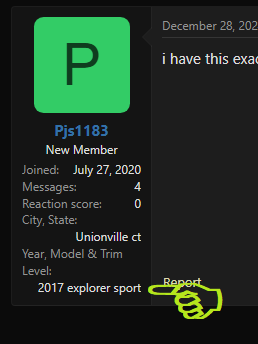

I'm not sure which member your post is directed at. Every post here shows a vehicle type in their profile.
Thank you for the diagram.
Peter
I guess something in my desktop browser or system or the forum skin I'm using made that text so large that it pushed the information out of sight in the area below the avatar. I can see some of it today...
...but the information still doesn't start on the same line as the heading (same for city).

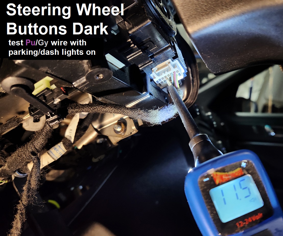

Remove the column lower cover, turn the parking lights on, and measure voltage at the Pu/Gy wire in the rearmost clock spring connector. If it's ~12V and the wheel lights aren't on, the fault is in the clock spring or steering wheel. If it's significantly lower, the fault is in the dash wiring.
