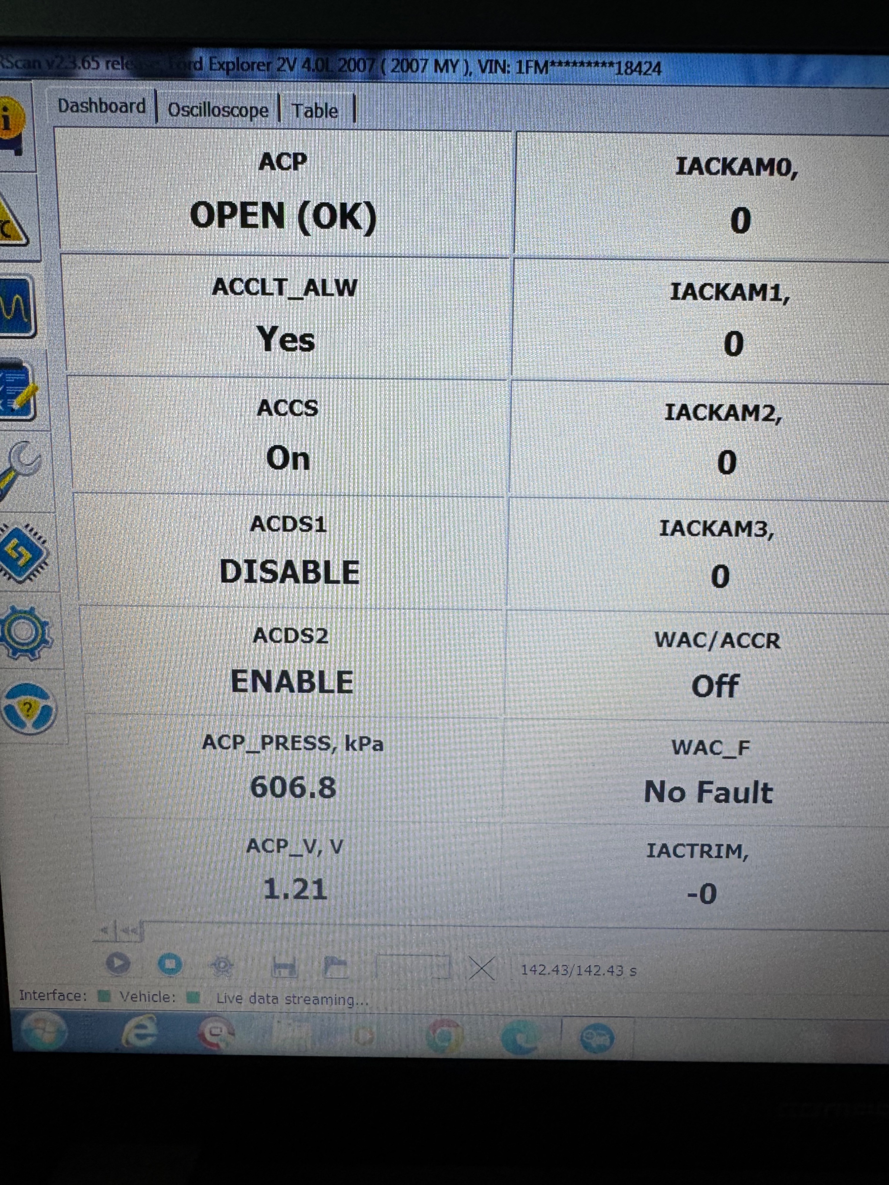

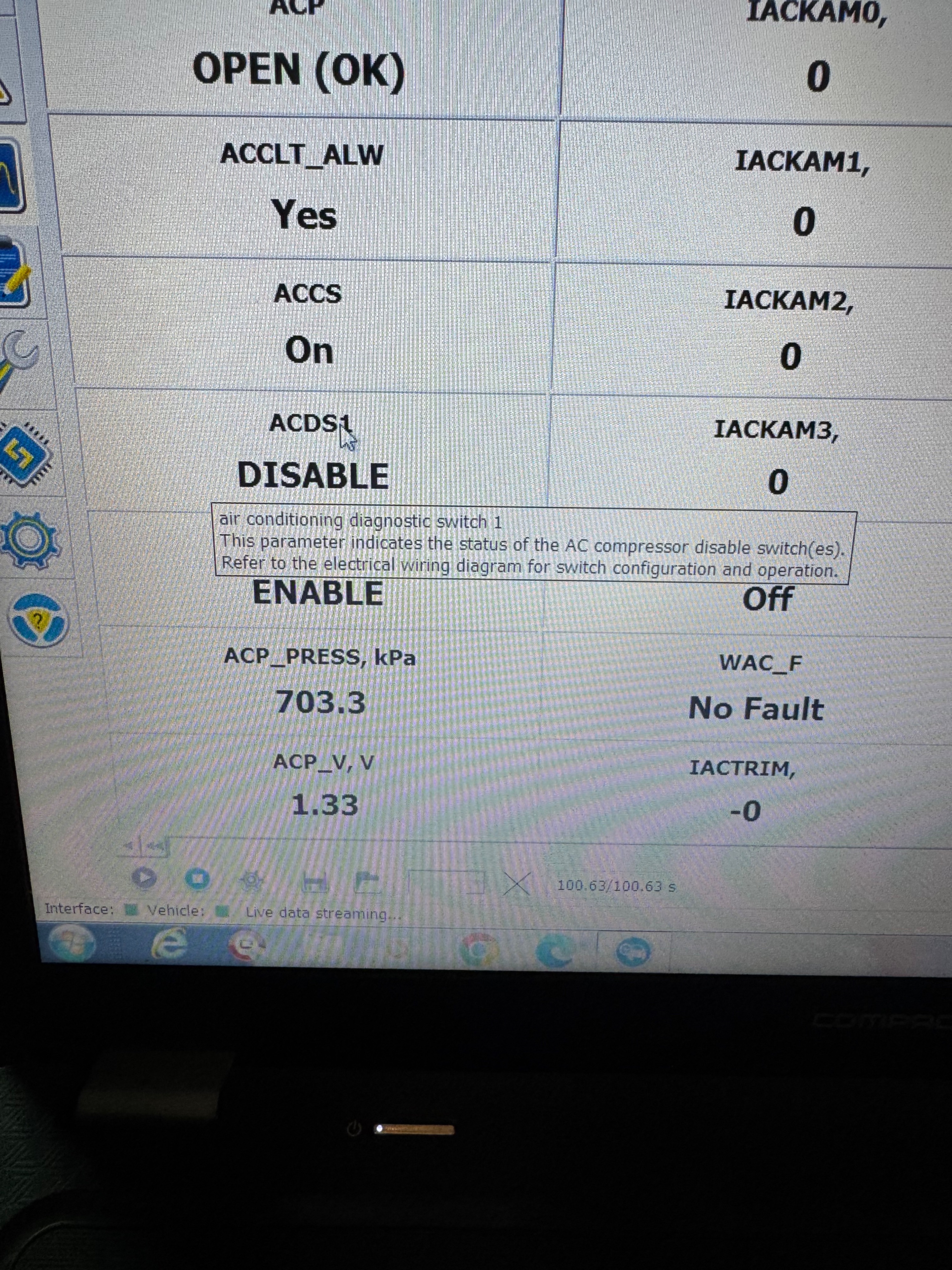

Ok so here’s where I’m at. I have been messing with the ac on my step daughter’s 2007 ford explorer. The compressor is not engaging. I finally downloaded the updated version of forscan and it’s saying ac diagnostic switch 1 disable. Please see attached images. What is ac diagnostic switch one and where is it at. Low pressure switch is good and on, high pressure switch is good, coolant pressures are good. Just have no idea what or where ac diagnostic switch one is.
Compressor clutch pigtail?
