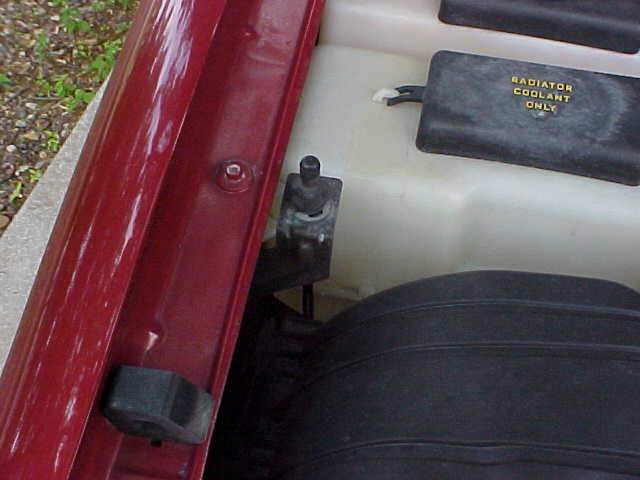

I'm confused. What do you mean by hood pin andy how did you bend it?
This is what he is talking about.
Pictures (I thought I posted them already)

Looks like that's done it! The hood pin that is.
No one's complained about it yet.
Thanks again.
