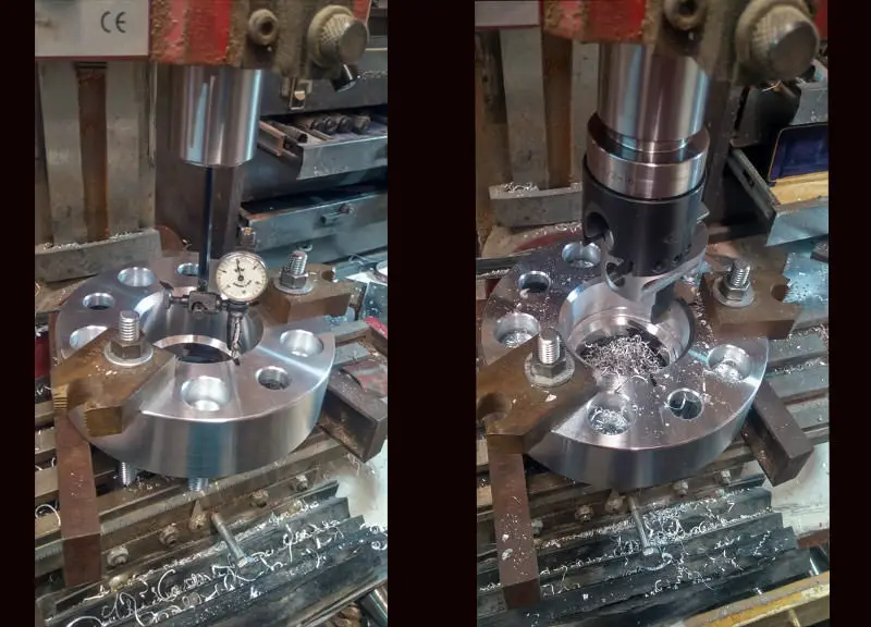

Ok so here's my solution for the rim problem. I found rims for a 2014 explorer off craigslist for $60 set. They were 44mm offset. Unfortunately, my 2002 sport has 12mm offset. To make matters worse the center bore for 2014 is 63.4mm and for 2002 is 70.6 Having never liked how narrow the sport sits I went for some hub-centric spacers. Finding the right bore was a problem.
The problem was the difference in offset, about 32mm or 1.25 inches. On the back I went for a full 2 inch spacer to sit the tire out a little farther. So I bored out the back of the spacer to 70.6mm and turned the collar to 63.4mm.
