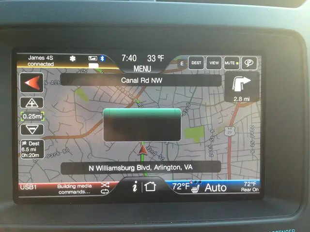

Anyone seen this before? Happened to me the other morning all the way to work, haven't seen it before or since.
(ignore the 'building media commands' which is perpetually there - it'll finish one day ... :rolleyes: )
I had it once, except mine was red tinged instead of green.
Hey, Jimmy-B!
I've seen this before and it generally goes away on its own. Yours looks like a NAV confirmation prompt got stuck on the screen. If it happens again, you can either wait it out or do a Master Reset:
MENU > SETTINGS > SYSTEM > MASTER RESET
Hope this helps!
Rebecca
Thanks Rebecca. Doing a Master Reset involves having to reprogram all my settings etc into the MFT so it's not the ideal solution. But the black box thing hasn't happened again, so I guess I'll just keep waiting for the "performance upgrade" ...
