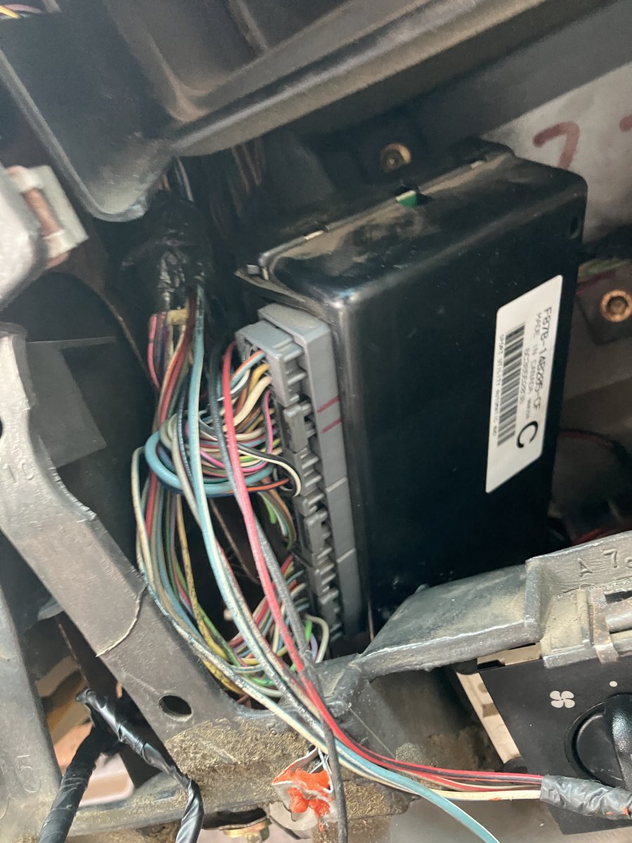

So I tracked the aftermarket bullbar light switch control cables and found no issues. However, the GEM control module has been sitting like this since I got the car. Somebody messed with it over the years. I checked how should it be sitting positioned, and tightened to its bracket, but wasn’t the culprit sadly, and still persist.

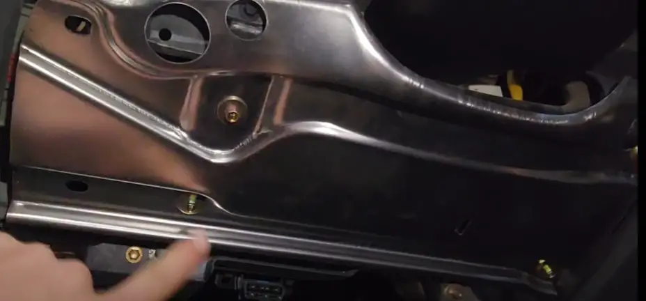

Yesterday I wiggled most of the connector around the steering column and everything was solid. However, I think I found the culprit. I think it was the brackets holding the shield/metal plate behind the lower dash panel (The shield/metal plate was missing since I have the car).

I bumped into the steering wheel with my head accidentally and heard a similar sound resonating in that area. The fasteners were rather tight but the bracket is very thin, especially in the middle, and not so rigid without a plate. The bracket doesn't need much force or vibration to emit that strange sound.

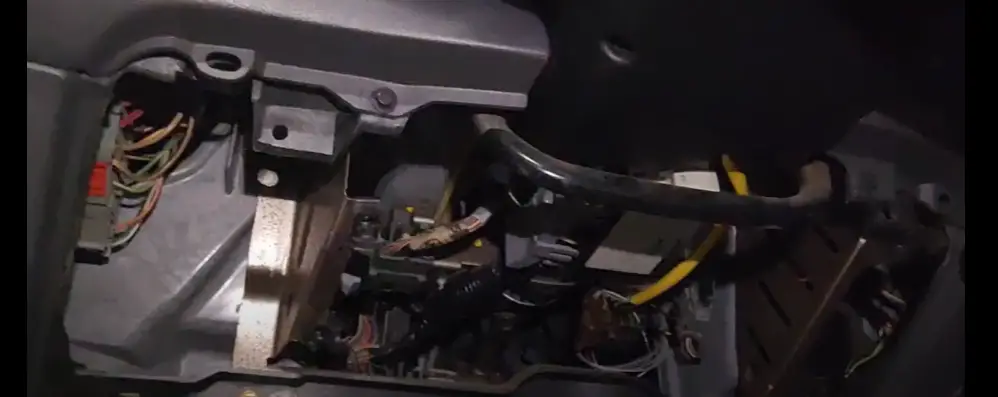

I have the lower column cover. It bolts up to a dash rail on the bottom to the same rail the OBD2 connector is attached. (1st picture)

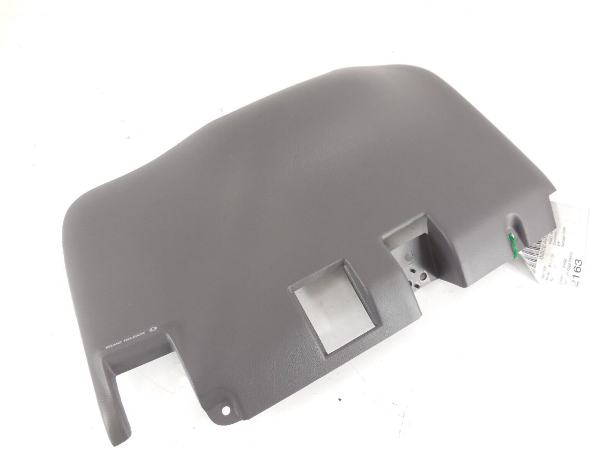

The plate that I am referring to is pictured on the 2nd pic and sits in a middle area pictured on the 3rd.
