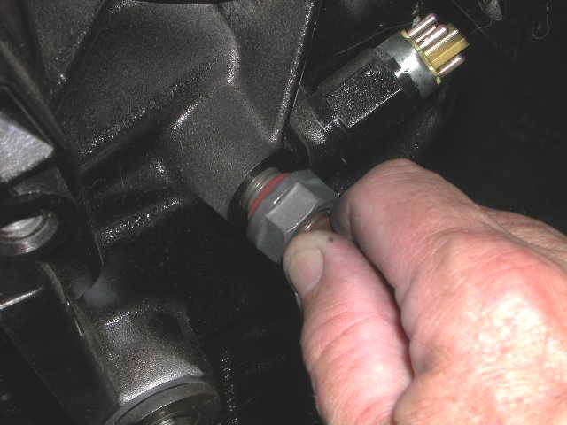

The DTR is adjustable. The neutral safety switch screws in. Here is a picture of it:
