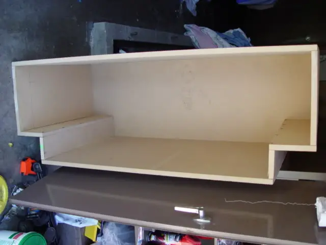

ok finally started on the box, i dont know hwo long it will take me but well see.
thus far ive built the main structure of the box (everything but the front and port). tomorrow i will make the MDF sub rings and port, and hopefully get it preped (or even get the first layer) for glassing.
i dont know how im going to do a glass structure for the amps (mounted on top of the sub box angled toward the back) but ill find a way...

heres some of my progress.
i have it built, but have no idea if it will fit, i might have to disassemble it and build it inside to get it to fit. if i do that, then ill just glass it inside the truck while its there.
More countersunk screws! Liquid nails/caulk the edges.... and bracing, oh my God bracing... please brace that enormous box some. Those 15" x.. are going to flex it like crazy.
Looks like a good start though.
yeah, bracing.
for the record the large flat back side of my box (3 9500 15s) is 1.5" of mdf then 1/4" steal bars (spaced so they cover it all with only a few inches between them max) and then 3/4 more of mdf... with 1.5" only it shook so bad i thought it was going to break.
the fiberglass part doesn't flex at all (10 layers or so everywhere)
err would ported flex that much?
got the liquid nails, just havent started using it yet, got plenty of screws, but used the wrong size bit to pre drill the current holes so i will be adding quite a bit more, none of the screws are counter sunk (yet).
so for tomorrow im hoping to possibly disasemble the box (after finding out it fit perfectly in the back) use liquild nails on the actual joints, and screw holes, then put it back in the truck then do the edges with liquid nails also.
the only bracing i was considering was the port brace, top to bottom (right in the middle of the box about half way deep or whatever it measure to be tuned to approx. 30hz). any other suggestions on added bracing design?? steel bars seem like a little much. i think i might use a 2x4 for bracing or even a 2x2, i wont be cranking it to the fullest at all times, just the occassional beating out someone that doesnt lower theirs at a stop.
this kind of sucks with no one to help me but myself. this is a 1 man project and i want to get it done before the end of next week (build and finished glassing), painting will come later
i did some MDF rings, but they came out looking like crap, im hoping it will hold the sub (which i highly doubt because the outer ring doesnt have much of a lip.
