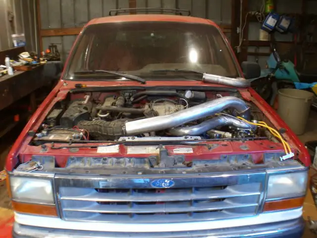

Anyway as some of you may remember a while back i had a first generation explorer with a 4.0, which i attempted to turbocharge (picture below)

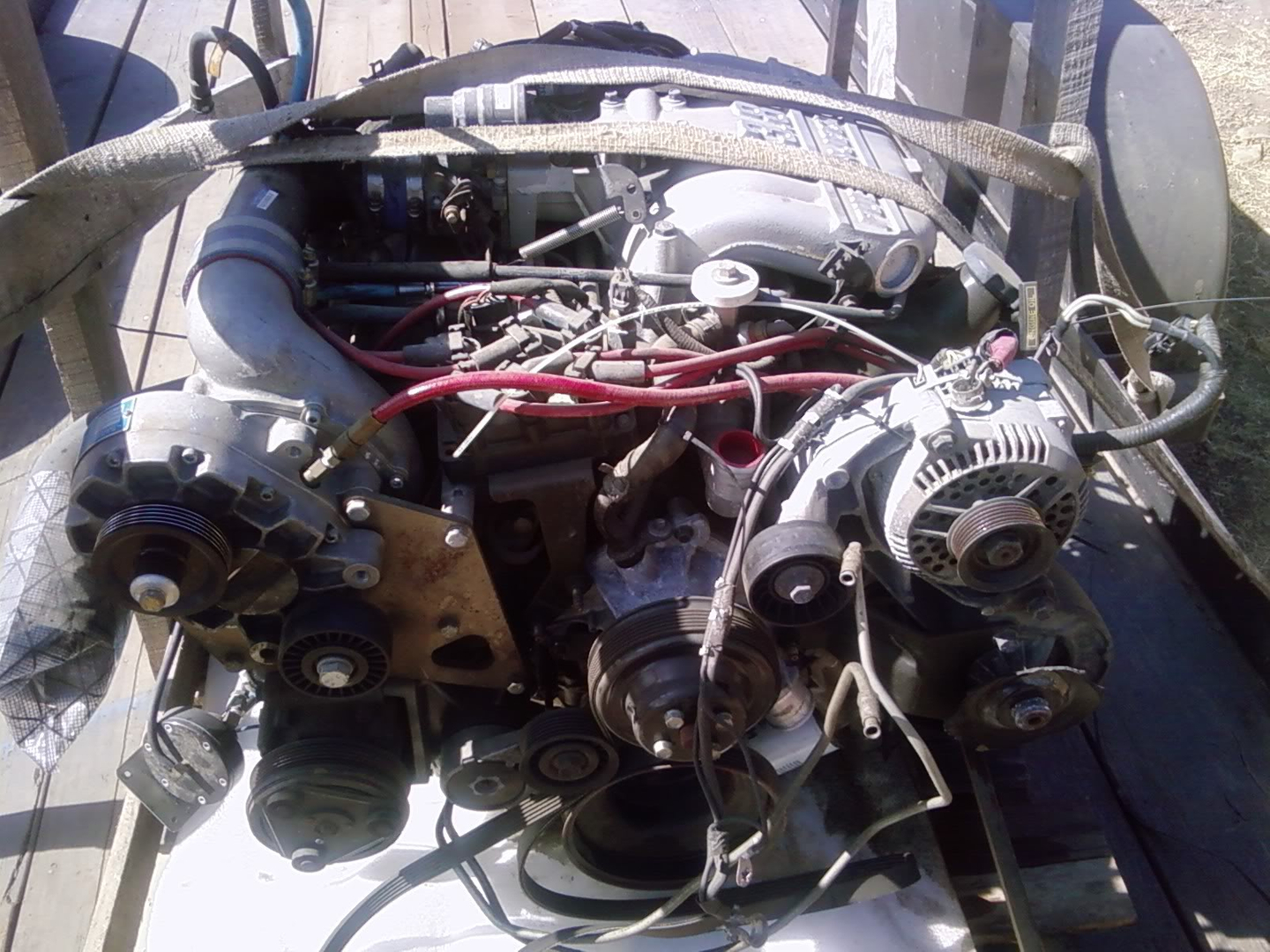

well, it made boost but without an FMU (among other things probably) it had problems, then i got this 3.8L mustang v6 with a vortech supercharger on it. so i decided that would be a better idea. heres a pic of that too.
i'll be mating this engine with an AOD transmission and T-case from a bronco.

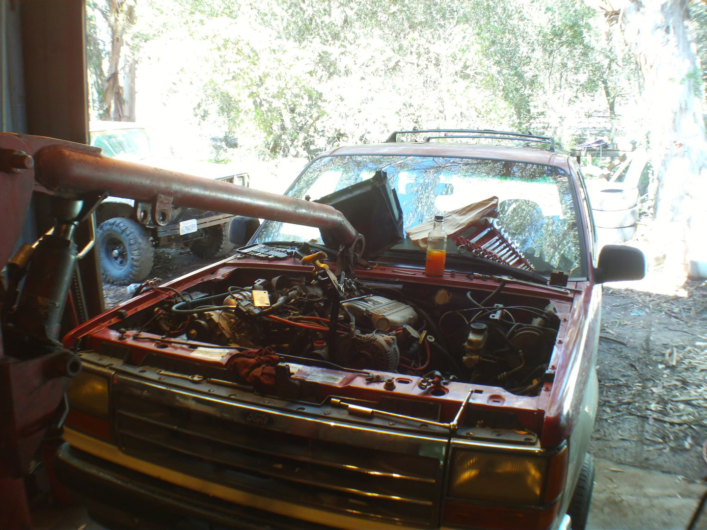

Well... i realize i got zero interest in this when i started the thread.. but i've got some more work done with it so far, so here's an update.
i've removed the old engine and trans
dropped in the new engine, had to modify quite a bit of stuff to make it fit (cut out the battery box, removed the heater air box... it may be tricky to fab up a replacement one!) and i've notched the frame rail in a couple of places.. the stock 4.0 is a 60 degree V6, and the one i'm dropping in is a 90 degree v6, so it's considerably wider! and a bit of a tough fit.

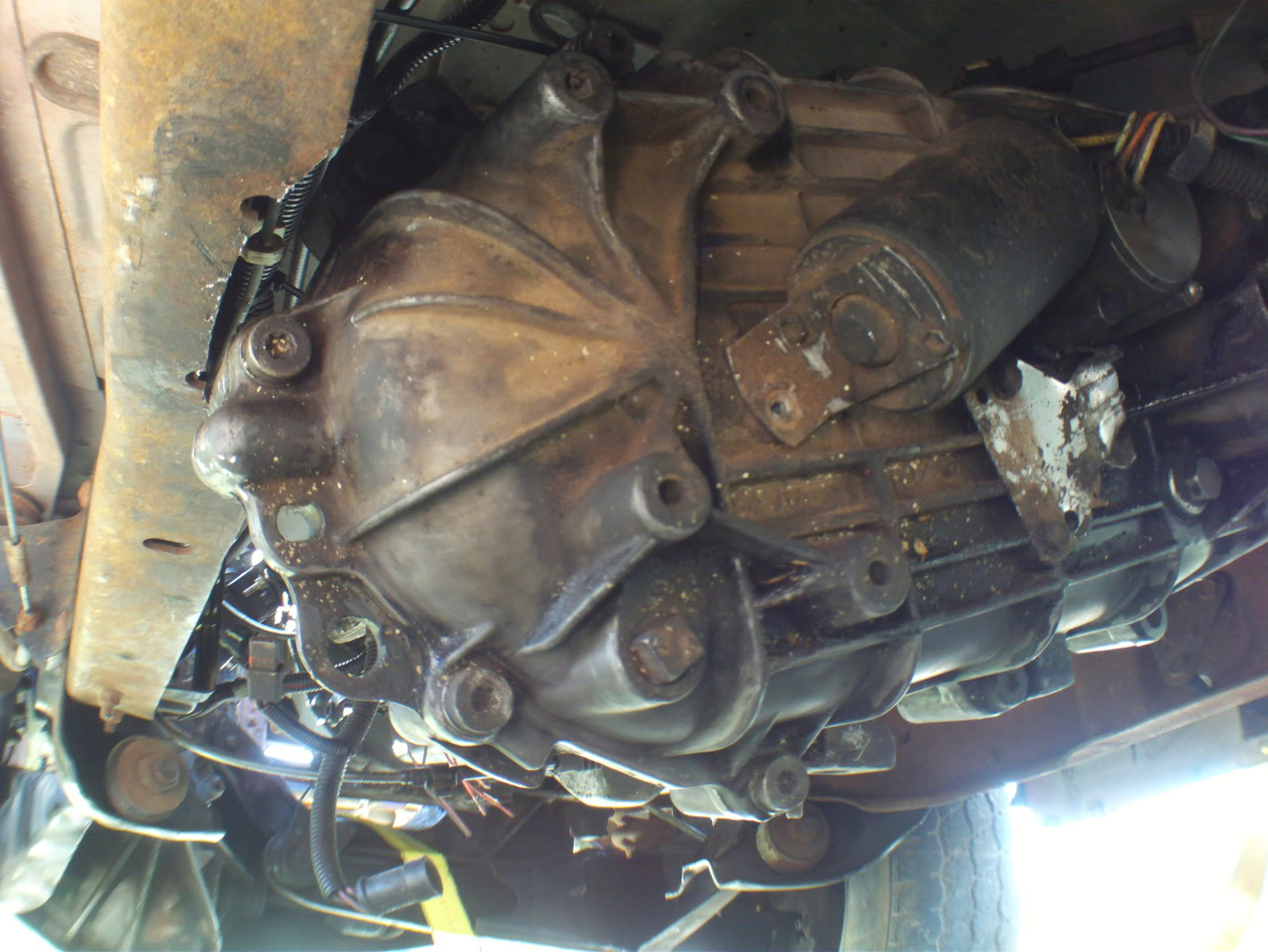

and here's a pic of where i had to notch the frame rail to fit the new transfercase (borg warner 1356 out of a fullsize bronco)
and another pic from the bottom
i still have to make engine mounts, modify the axle pivot brackets (and possibly crossmember) so the engine will drop down the rest of the way, make a transmission crossmember, and modify the driveshafts. but it's coming along nicely.. hopefully saturday i'll get a chance to make some more progress!
