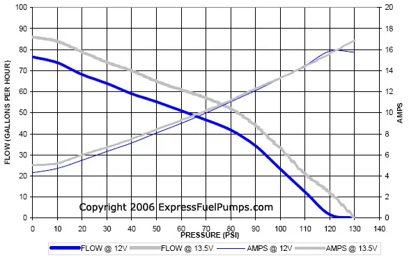

I wouldn't just assume it is the pump. A properly operating Walbro 255 should be enough. Do you know the model number of the pump? Fuel pump volume goes down fast as fuel pressure rises. You might have a pump that is intended for lower fuel pressure demands. Knowing the model will let you look at the flow vs. pressure curve for the pump.
Walbro GSS342 Intank Fuel Pump 255LPH High Pressure (Universal)​
Sorry for the caps
This should be the chart for your pump. At about 77 psi (67+10) your pump is delivering about 43 -53 gph depending on voltage the pump sees. Can you or Lasota tell, or estimate, your the fuel demand in gph at near WOT? My gut is telling me if the pump is working properly then it should be enough. Is there any estimate on how much hp you are making?

Yes, give him the pump model and let him know it's two years old, plus the returnless detail(no FPR vacuum referenced).
