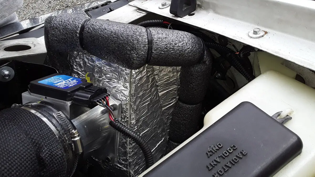

I tested the foam at 300f With a heat gun
just shrunk a bit its pipe insulation

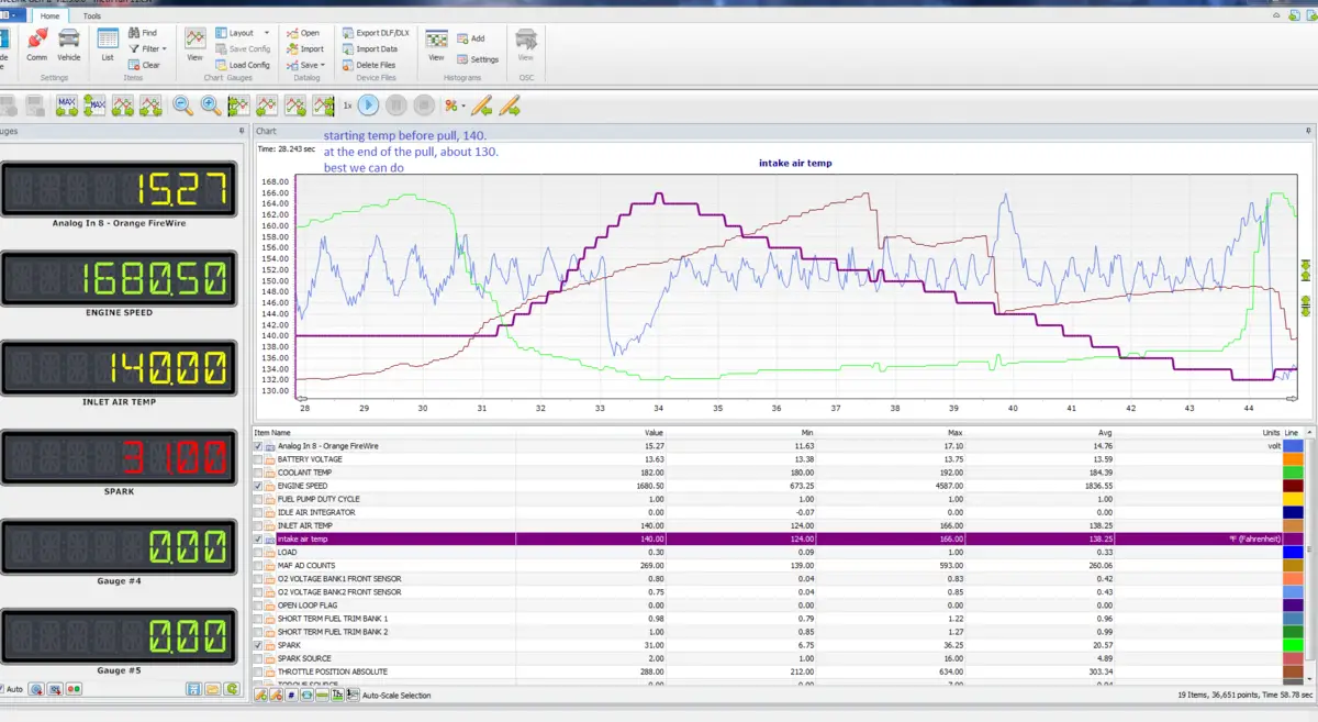

Looks better more water??
This was not a full pull just a test
That's an engine bay ready for business, it's looking good. I love the aluminum tape, it's very good stuff. That makes me want to build an air cleaner finally, for a big filter I got years ago(but it looks too big).
Do you know the response time of the temp sensor? How quickly it adjusts to temperature changes? I wonder if the IAT is actually lower but the temp sensor doesn't have enough time to get an accurate reading. I would try more water. You might be better off with the cooling effect of more water than the octane boost from the alcohol.
That's the plan 70/30
Be careful changing W/M ratio, it changes the air fuel mixture.
If you add less methanol your mixture will go leaner and the PCM does not compensate at 70-100% throttle.
If you are still in the tuning process make sure you tell your tuner that you are changing the W/M ratio.
Let him know you are experimenting to get the IAT's as low as possible and see if he wants to tune the A/F now or later when you decide what W/M ratio you are sticking with.
Will do
But he did say it was rich
And to get the iat down
Ill massage him

i think we are there knock on wood
here is the e mail
10:01 AM (33 minutes ago)
to me
Hi, One run the temps were excellent and timing went right up. The other one, they were at 160 and the PCM did its job and pulled spark. I think it is heat soaked on the second run. I do not think adding for meth is the answer either. As it is pig rich now. We do not want to decrease fueling, as we already did, we like to keep it safe if the meth fails to save your motor. You should be good to go as long as you realize it does get heat soaked. And the PCM is doing what it is supposed to do and is pulling timing.
Don
Okay, you are getting it close.
The good part is if I can get a faster iat sensor
It will add timing on its own
But believe me its a lot faster than 5lb boost was

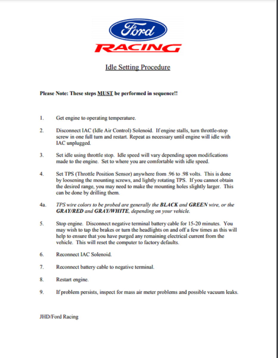

I got a bit of a yoyo idle when hot
I think I can do a idle adjustment
