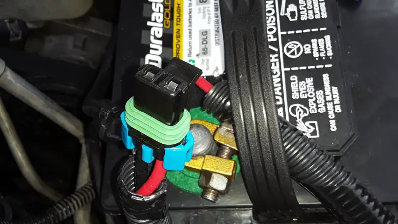

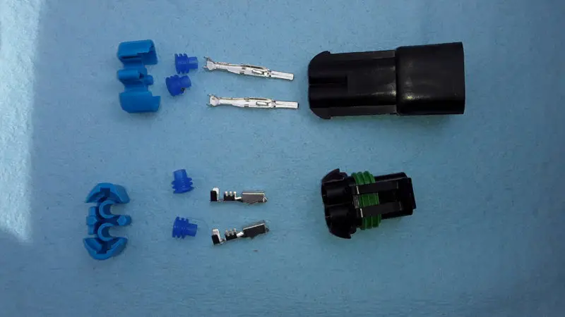

( Delphi Weather Pack 2 Pin Sealed Connector Kit 12-10 GA | eBay )

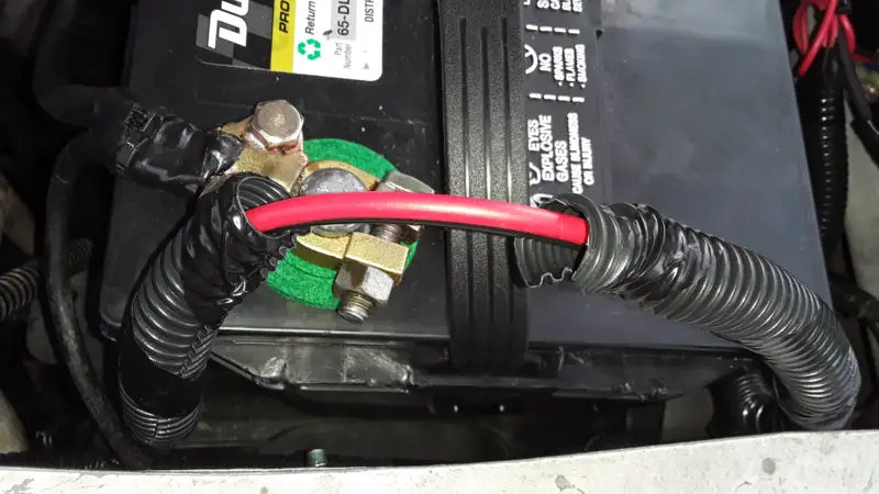

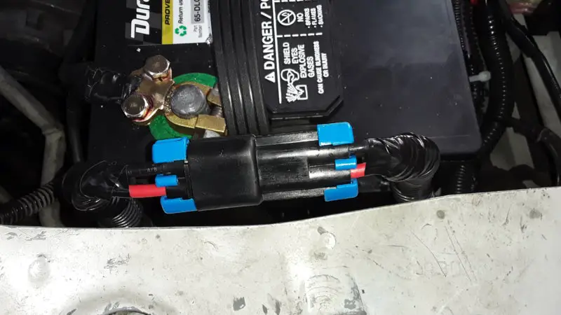

decided to put a connector, ^^^, to give us the ability to remove the fan because we didnt think of that before and now it is in. the camera made the soldering job look horible but it was a good solder joint which we also crimped with the proper crimping tool.
this wire is supposed to be 10 gauge but is more like 8 gauge so it baerely fit in the connector, the connector is rated for 43 amps. we appericiate comment on this thred so please leave them.
we also changed the inline transmission filter and with the old one decided to open it to see what the filter was looking like and it was CLEAN, the filter was on for exactly 1 year and took about 4 ounces of transmission fluid to top it off after we changed the filter. the magnet was used else where. this filter does have a functioning bipass valve. we appericiate comments on this thred so please leave them.
