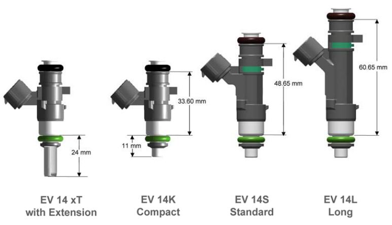

I think the key is the length ..stock posted above is 60mm long ..

so ive learned a few things, injector length
0280155900 / XL2E-A1C
stock
the m9593g302 injectors are the only medium injectors on the SCT list posted in the picture above and here.
so the m9593g302 47lb Ford Racing injectors seem to be the best choice for a factory type bolt on replacement, and very tuneable. Thoes injectors are very easy to find new, and match the specs of the factory injectors specs.

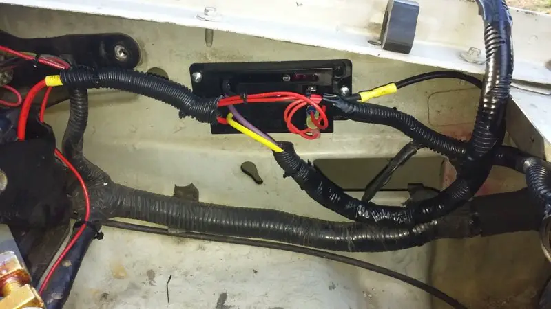

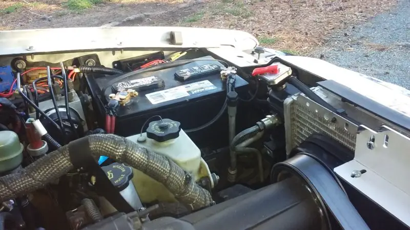

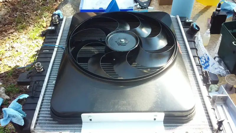

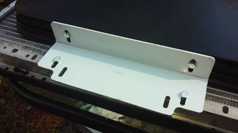

got the fan installd ita a flex a light 180 kit i also got a 2 speed controler whitch is nice than the one that came with the kit total thanks for your advice @4pointslow
I like it a lot, but for the wiring. I love the fan installation, I have a 180 kit also to put in one day.

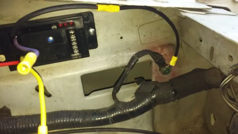

Did you solder the high current connectors? Those really should be soldered, not solely crimped. I remove the insulation from butt connectors, and feed solder into the joint after crimping. Use heat shrink to cover them up afterwords(put it on first).
We tried to do the best on wire routing as we could soldering is a good idea I was thinking the same I'm most likely gonna solder them
ut for the wiring
Please tell me exactly what you mean just the butt connector s or the routing or both lol
Tell me what I did wrong
Thanks for helping out :)
Your routing is all fine, it's just the main power wires to the fan I wonder if you soldered all connections.
Low current wires etc, are fine to just crimp, the heat isn't high so those can last forever. High current connections will create much more heat and are likely to become issues if the connections are just crimped.
So an electric fan that can see 40+ amps on start up needs solid connections, so vibration won't make them fail. For any connection made for high current wires/circuits, use solder at each one. It means removing the insulation from most connectors, to access them enough to get a soldering iron into/onto them. Most ring terminals you can solder easily with the insulation part in place.
I like to buy un-insulated connectors like butt connectors just for larger wires and current. But you can cut it off any connector, and still solder it.

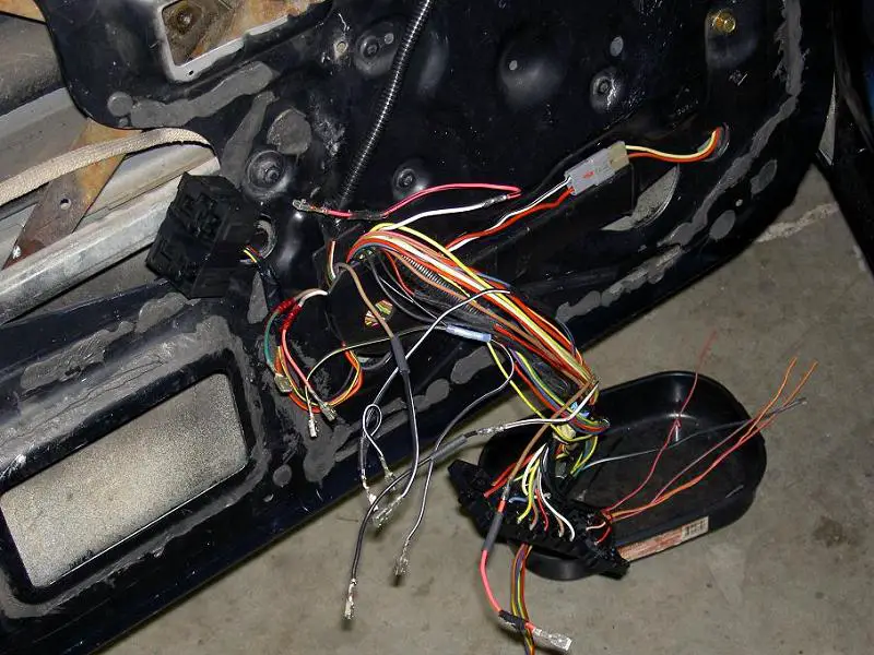

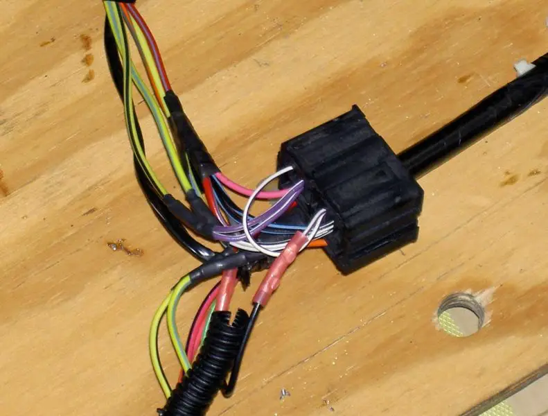

In my power window wires for my mail truck, I had to solder a ton of the connections going to the many added relays. But the small trigger wire connections I didn't need to solder, tiny wires and low current for those. Below is a picture of one pair of relays I used for each door, these added control of each window by a 2nd master switch on the RF door. See that there are only two crimped connections, the rest are all soldered. The two with pink insulation are just the trigger wires.

The fan only draws 18 amps 3300cfm
But I do agree I will be soldering them
Connectors are fine, granted they are quality AND crimped properly. I run controls all day (including a lot of high amp/low voltage) and have had very, very few connections fail.
if your connectors (or wiring) are getting warm then it’s too small, or you have a bad connection. 18 amps is nothing, and that’s probably just an inrush spike you couldn’t catch with a meter without using the peak function.
Also, for the record my wiring OCD would have me soldering them.
That's why I do it, in a vehicle with vibrations, connections run hotter and fail/corrode more easily. A full power fan often hits start up peaks way above running current, that's why you hear of 40-80 amp relays being used, and those failing sometimes.
Yea I'm gonna solder it
The fan controller has soft start
Comes on with the a.c.
And is variable speed
I will be soldering tho I knew what I crimped them I was wrong I love the input
