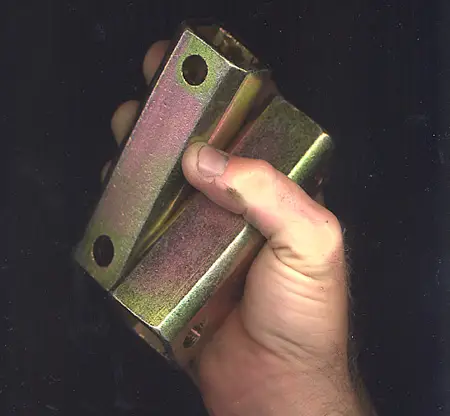

The only blocks I got are some gold 1 inch square tube stock. Are these them? I sure hope so 'cause that's where I'm bolting them! So I guess I'll ditch the funky cross-member.
thats seriously odd..... mine didnt say anything about dropping the front drive shaft..... and your blocks dont look like mine?
My blocks are about three inches long gold anodized 1 inch square box tubing.

Those are your bump-stop extensions there. It sounds like your missing the anti-sway bar drop down brackets...
Well, they're not the bump stop extensions 'cause I put those on yesterday! But they look very, very similar. The bump stop things had slanted crossed supports inside. These are hollow.
they are the same as mine then.... the sway bar goes in front of the axel..... look at my pic again.... closley tell me if thats them... and if it is ill help ya out.
I agree that the sway bar has to go in front but your spacers look a lot taller than mine. Yours look to be about 3 inches tall whereas mine are only one inch tall.
Here's a picture of them.
those look like the holes are proper spacers to be sway bar drop down brackets.... try putting them as a lowering bracket to your front sway bar.... see if you have enough clearance.... its worth a try
