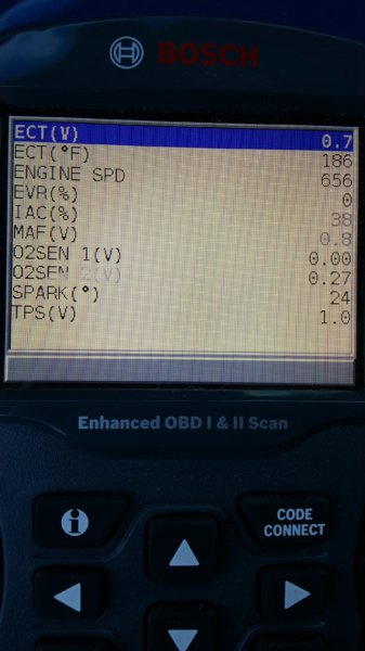

Alright, so before I replaced it, I took some pictures of my fancy computer readings. All of these were taken with a warm engine.
Idle
35 mph
Am I seeing live data from a 1994 Explorer? Just want to confirm that the Bosch 1300 supports live data from the OBD1 Explorer without any modifications, before I shell out the cash for one.
Yes, that is OBD-I live data as the bosch displays it straight out of the box.
There's more data it also displays live not pictured.
HMMMMMMM interesting! I might just have to spend the money on one of those.
What do you use to compare the data to see if it is good or bad numbers?
