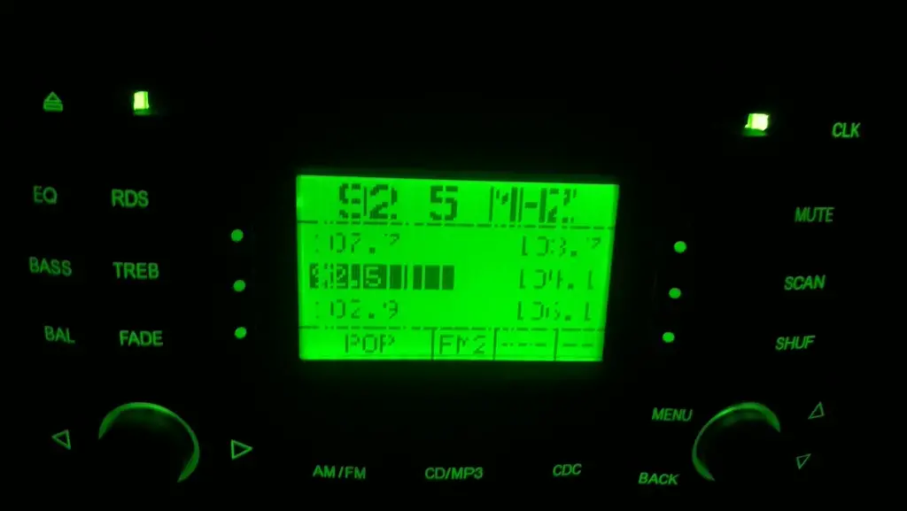

The past few days, my project has been swapping a Blaupunkt factory radio from an 04 focus into my ST. I found mention of somebody putting one in a 90's Ranger, but couldn't find any pictures or other information.
It turned out to be a fairly straightforward procedure...
The radio being a factory ford is nearly the same size as ford trucks, and the same mounting system. the dash in a focus is curved, therefore the radio is as well, but I don't mind the look in the ST dash at all.
As far as wiring, it uses the german blaupunkt connectors, so I used a couple of Metra harnesses to adapt it, and it seems to work just fine. The antenna is also a european style plug; an adapter took care of that. I went to a local car audio shop for parts, but they're also available on amazon.
Physically, it slide right into the ST radio bezel, but sat into the dash about 3/4" too far. Not a big deal, but I made some aluminum brackets to bring the locking point further out.
sorry about my grimy interior! my sport trac is a truck, and I use it as such.
I'm no audiophile, but the new unit sounds better than my previous ford unit from an 07 Ranger. It's capable of much more volume (will distort the factory speakers) and generally better bass, mids and highs. I like the interface and options.
I have parts coming to allow an aux input though the CD-changer that I obviously don't have, will update when that happens.
Looks good. Is the screen LCD? Can you post a pic with it turned on/lit up?

Unfortunately my ebay unit's display has seen better days. the LCD has a bunch of dead lines. I pulled it apart in the hopes of something obvious I could fix, but no luck.
It was a good deal, and I'll keep me eyes out for one with a better LCD.
It functions 100%, just a little hard to read sometimes.
You know I looked at these radios for sale on eBay (average price was around $45-$50) and every single one of them had the dead spots on the display. Must be a common problem with that unit, like the display going blank on Mach radios.
yep. I missed one, that was perfect. they show up. I poked around a focus forum, it does indeed appear to be an issue. It's a shame it's not fixable.
