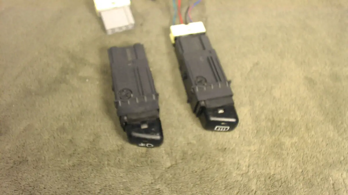

Remove the radio, remove the radio bezel, unplug all the electrical connectors, unscrew the offending switch, look for a small twist out bulb base and turn it 1/4 turn to remove it. The base is part of the bulb. I've found replacement bulbs with the base, but some just find the bulb and reuse the old base, but that requires soldering.
In the pic below (not the clearest) note the small round circle near the left top front of each switch. That's the bulb.
The bulb needed looks like the image below, not sure about which size. They are listed ad T5, T3 and T4 (left to right) and are available in LED or incandescent bulbs.
