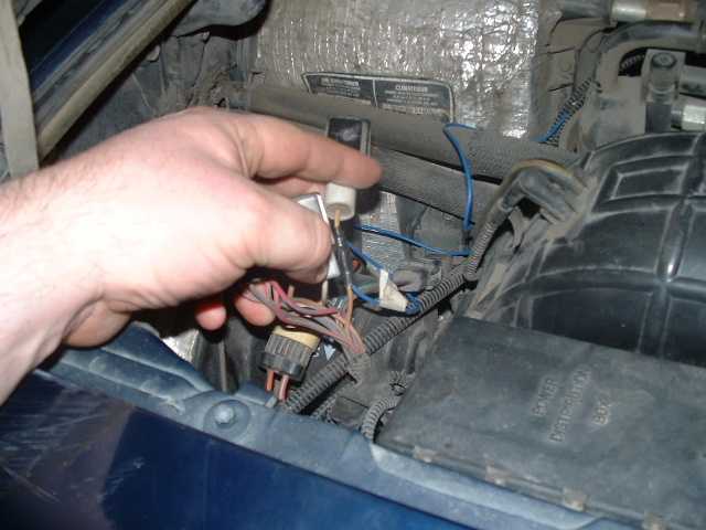

Hmmm well I think I originally hooked up my tach wire then disconnected it. It was somewhere near the fuse realys in the engine compartment. I will check and find the wire color for you.
the tach wire also goes through the engine harness into the body harness on your trucks (the big white plug on the firewall)
It is typicallt brown with a yellow tracer
here are the pics for tach wire connection

I guess it is a teast port or something cause I chased the wire to there and figured it was the easiest place to tap in for tach
Does that help???
I took 4 pics

thank you kurt...your pics helped out a great deal :D
but did it work????
yes it did
