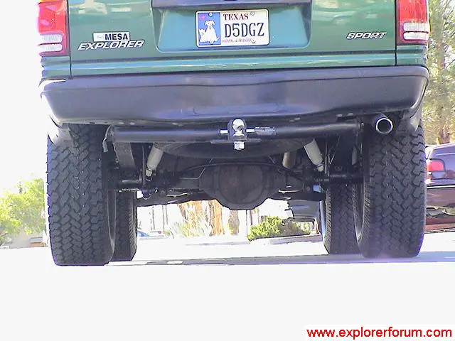

I know what you're thinking, this post is not in the wrong forum. I'm talking about my Explorer. I just got my new differential installed along with my 4.10 gears, and figured I'd get a nice new differential cover too. What do you think?
Compare it with the old, stock cover:
BEFORE-
AFTER-
