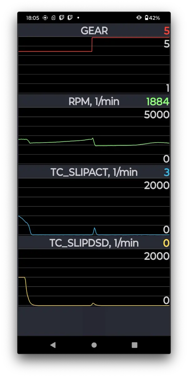

Since I got my truck 50k miles ago, it has always had a slight RPM flare when shifting into 5th (OD) gear.
It has always been a small flare. Maybe 100 or 200rpm. And it hasn't gotten any better or worse over the time I've had the truck.
Under certain heavier throttle / higher speed shifts it won't flare at all. It's almost 'worse' when accelerating very gently.
Today I recorded a few PIDs on ForScan, and was very surprised to see that there is a 'blip' on TC_SLIPDSD when the shift into overdrive happens.

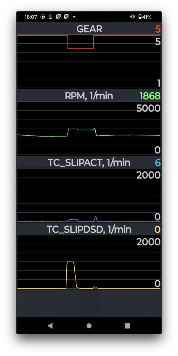

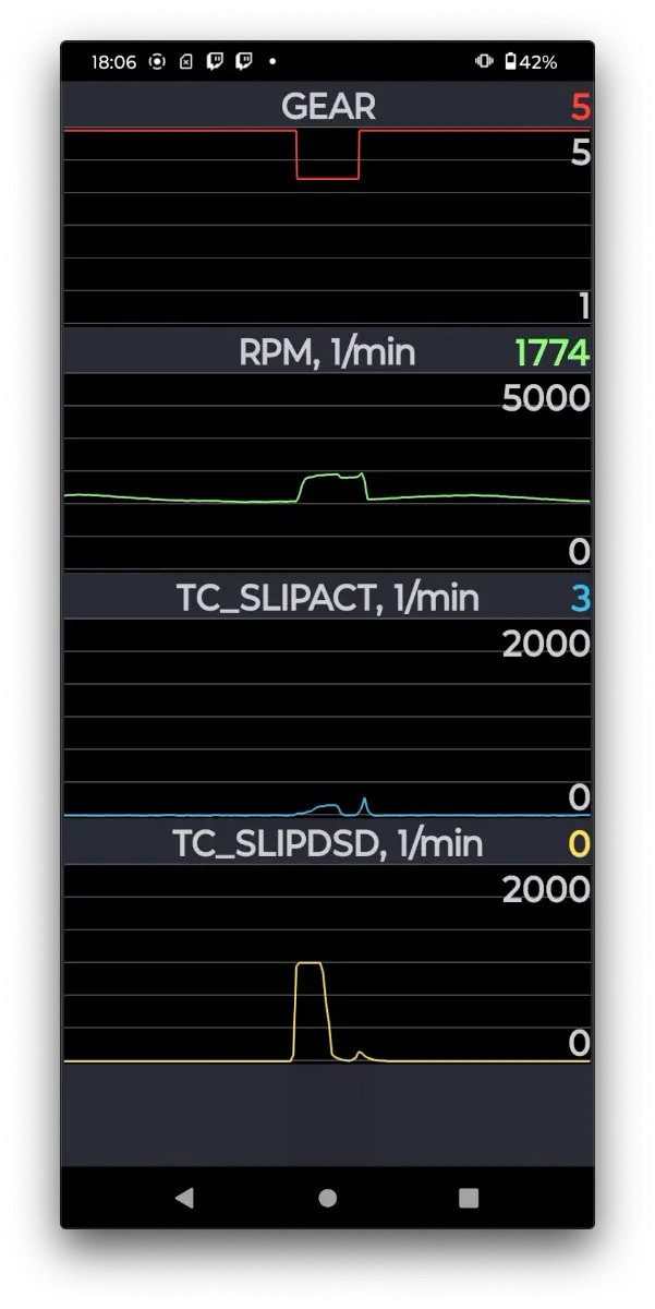

The pics show first a regular shift into overdrive from joining a 55 zone, and the second two are me disabling overdrive and re-enabling it while cruising.
You can see the small RPM increase I'm talking about.
Is this normal?? If the blip is appearing on the desired PID that must mean it is actually being commanded by the PCM or some other module? Right?
I guess I'm wondering if this is causing extra wear on the TCC or overdrive band?

I don't know if this small RPM increase is normal, to my feel there should be no slip.
Normaly the RPM's fall down 200-300 RPM while the transmission shifts into 5th gear.

I don't think it's normal either. I've tried watching various 'test drive' videos of the same truck / transmission on YouTube etc and I can't hear anything other than a straight drop in RPM when hitting 5th.
Possible internal pressure leak. I have no way of verifying. Only thing is, every other gear change up down and in between is flawless - always.

Up until yesterday I thought it was overdrive slipping, but now with the data from ForScan (TC_SLIPDSD) I'm thinking it's actually the torque converter being commanded to open up for a sec when shifting. Since you can see the data in the pictures.

I posted this on another forum and an ex Ford transmission engineer said that the torque converter is commanded to have a small amount of slip during the shift so it's smoother.
This makes sense, and explains why it hasn't changed in 50k miles, and also why under heavy throttle it doesn't really do it. Presumably because of the harder shift commanded at load.
