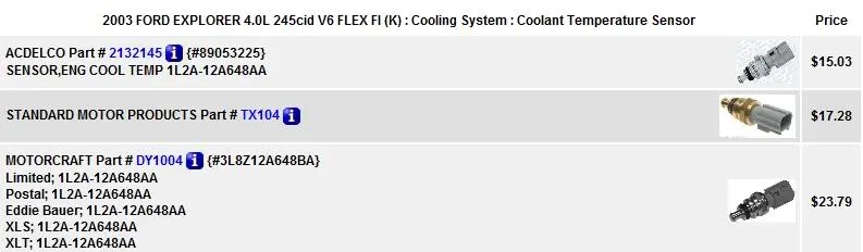

I believe the Ambient Temp Sensor is for the HVAC Climate control. Sounds like you need the Coolant Temp Sensor....
Its coolant temp, nuts, RickM is on it. . . .sorry about that. I was thinking the outside temp . . .
I have a question, what is the difference between the 3?
or do I just need to buy the 3rd one since i have a XLT?
Thanks!
It appears they're all the same part number... 1L2A-12A648AA.
Just double check when ordering. These prices were from Rock Auto.
Well what I meant was the part numbers of the 1st and 3rd item are the same but the prices arn't does it matter which one I decide to go with? Also to swap them out should be pretty simple? thx
